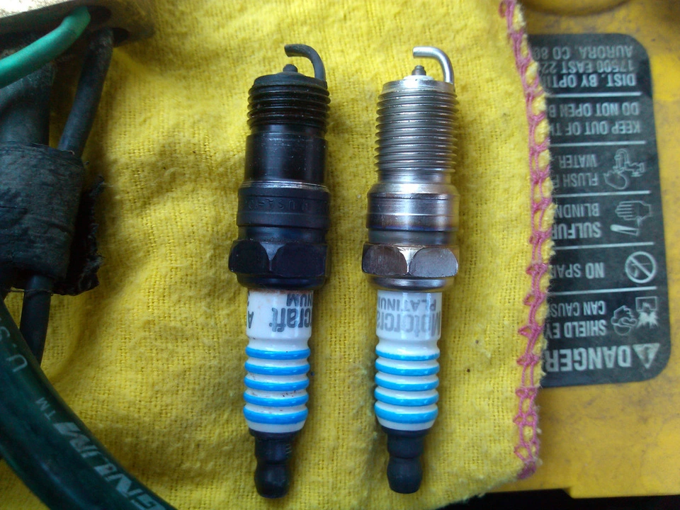

The old plugs were Motorcraft Platinums (AWSF32P) I took one to autozone and they said the AGSF32PM platinums were the replacements so I got those, the new ones have longer threads which threw me off at first, also out of curiosity I checked the gaps on the old plugs and it varied from .63 to .74 (!??) I've read the gap widens as the plugs age so im guessing these had been in there for awhile lol.

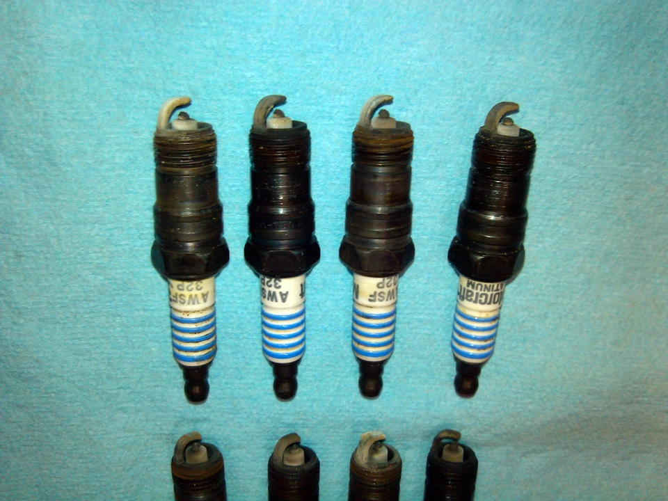

I took a few pics and was curious if you or anyone had any feedback on their condition, Some seemed pretty normal except a few had a white powder appearance on the tips, not sure what would cause this?
Old vs. New difference in threads:
Old plugs:
Glad it worked out for you. I have seen plugs worse, but those have been in there a while. Do you use fuel additaves? Sometimes the stuff can cause some deposits on your plugs. Some octane boosters are known to make plugs a funny burnt red color....others leave an ashy white residue. They look fine really....other than the rust and being pretty old.
The reason the new models have more threads is because they changed the heads in 04. They had a problem with spark plugs blowing out because there was only like 4 or 5 threads in the head. The 04s had 8 thread heads. That is why the new ones have more.
