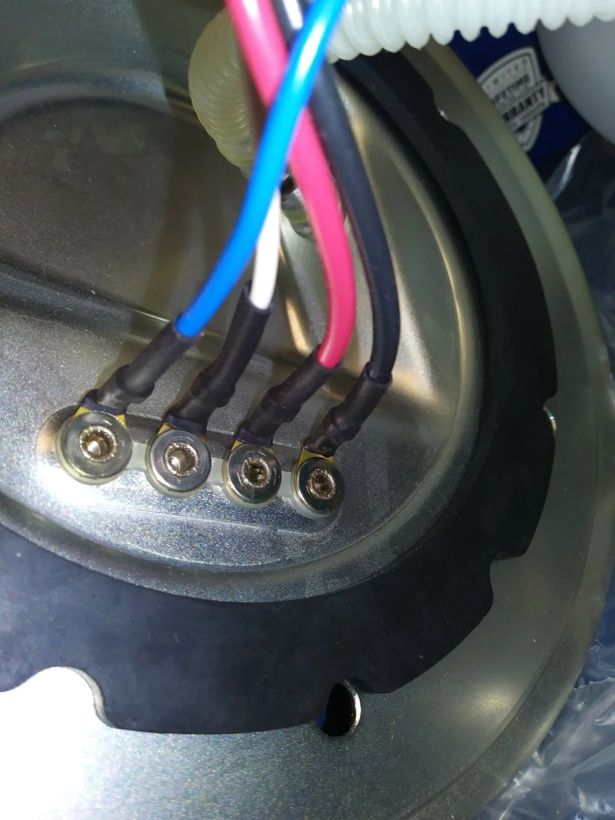

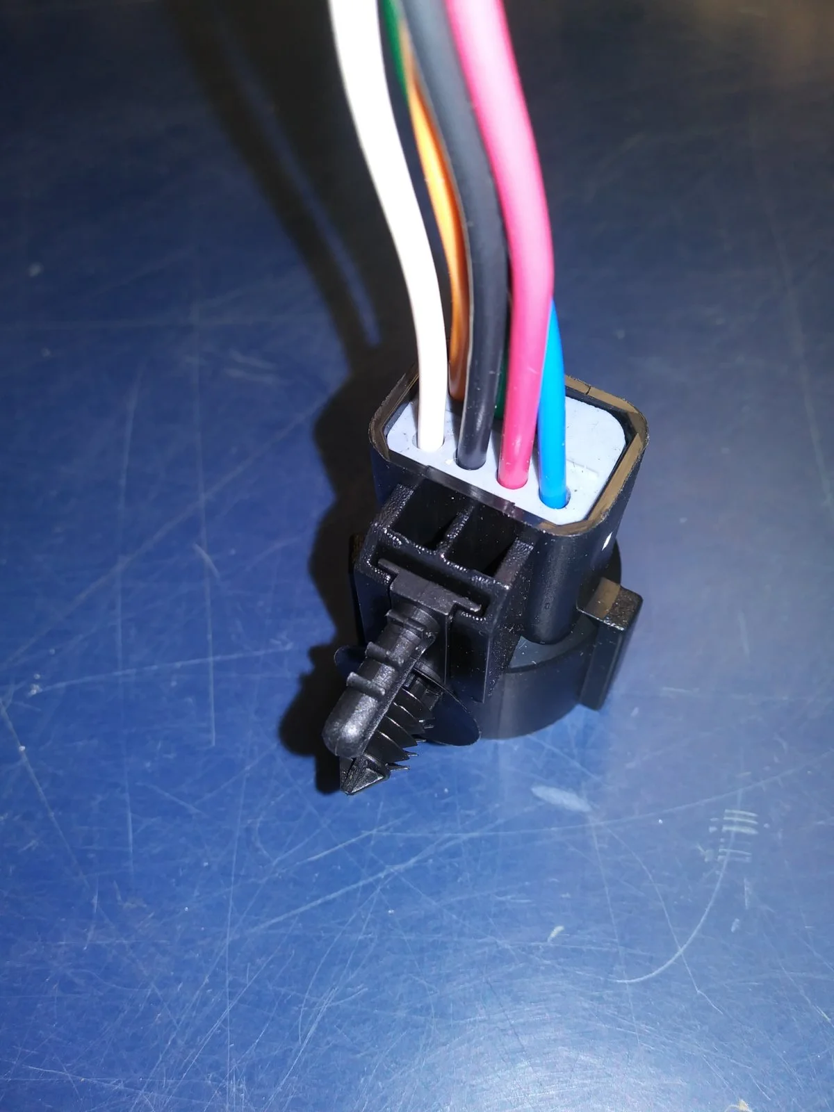

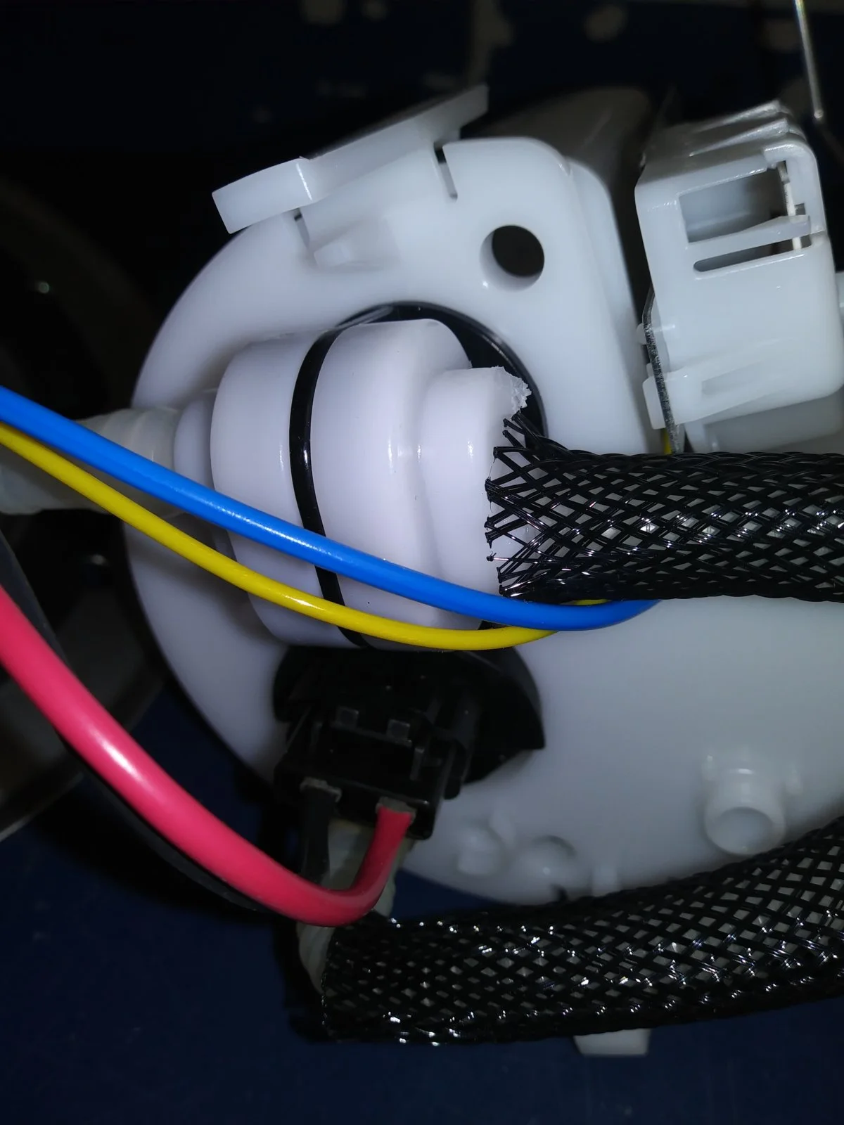

New Spectra pump # SP2244M helped me confirm 2 center pins are the red & black fuel pump wires.
