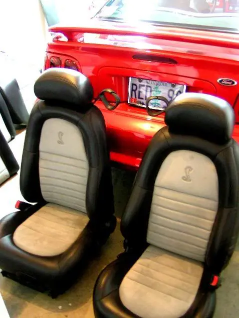

I know I said that I was going to have to ease off my spending for a while, but these were too good to pass up.. I got a set of 2001 Cobra seats on ebay, front and rear, black leather outside with light grey inserts. my question is, I know the seating changed from 1998 to 1999. I think the tracks are different. Does anyone know how big of a hassle it will be to put these seats in?

OK they're in :nice:
Turns out my car was wired for power seats on the driver's side all along, but my cheap cloth V6 seats weren't power. So, now I have a working power driver's seat. That's pretty cool.

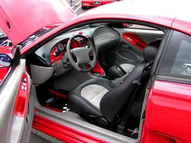

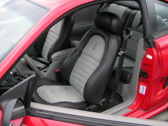

These were taken at a Mustang show in Vancouver, WA on 7/20. I got 2nd in the 94-98 class.. 1st was taken by a purple GT with a lot of buddies voting for her! It's all a popularity contest, you know..:p :bs:
