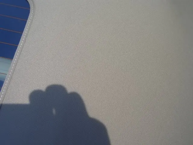

Just go canvas and be done with it!
:drool:
