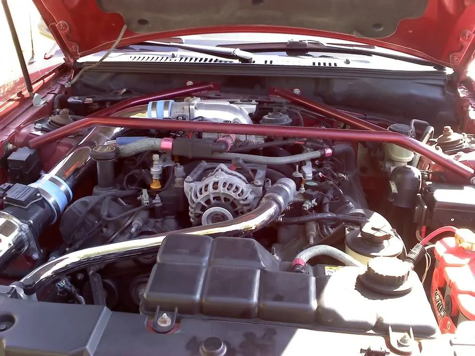

Here's a pic of the engine. It is a 4.6 DO and 90% of the parts have been replaced from the original to make up the HP to meet the Cobra-R requirements. I wish I had the 5.4, but they are hard to find in decent condition:)
