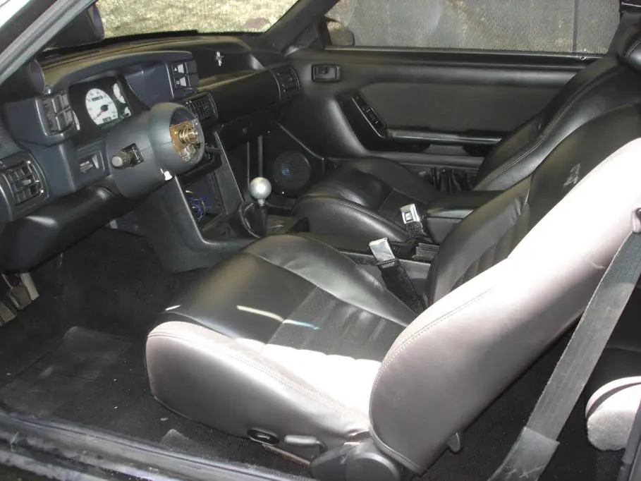

So the seats are in and they look pretty good imo.I cut the plug from the old seats and spliced/soldered it to the new seats.Power seats and power lumbar work perfect.The seats really don't sit much higher than the stockers do while in the lowest position.Heres a few pics (yes , thats my license plate in my wind shield) I'm in the process of doing the body, getting it ready for paint real soon.
What yas think?
