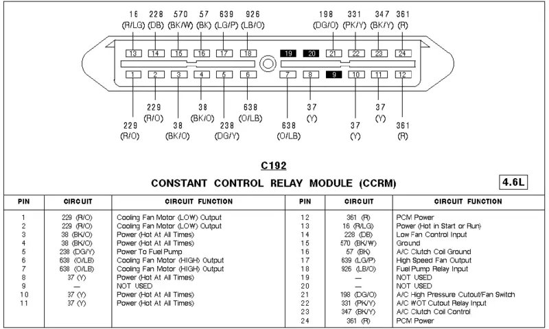

To hotwire the fuel pump to see if it will run continuously:

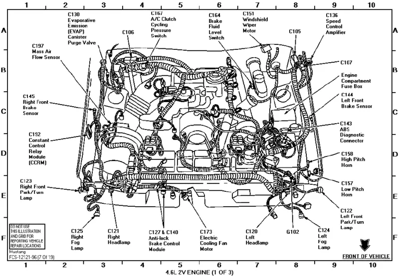

You can jump it at the (CCRM) Constant control relay module connector 192 in the diagram above by jumping:
[Pin 11 - yellow wire]
--and--
[Pin 5 - dark green and yellow wire]
