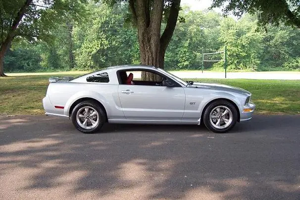

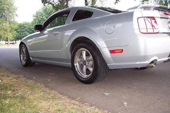

Stangnut said:
Aren't those a little taller than stock?
Yes, they are a bit taller and a lot wider. I wanted to "fill up" the wheel wells without lowering the car, and I prefer the bigger sidewall as opposed to the narrow "rubber band" look. Just personal preference.
Stangnut said:
How much is your speedometer off?
Should be off 1.4mph. I have been told I can have it re-calibrated, but I haven't looked into that yet. The car was delivered March 30, it now has 670 miles on it. Just a weekend toy.
