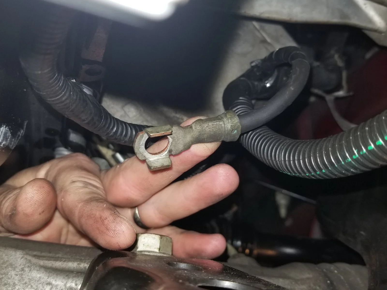

I have two more things to do to finish my engine install. One is easy, but this ground wire is not showing me where it wants to go. Can anyone help with a picture of where it's home is? It seems like it is supposed to be on the ac compressor but I am not sure. I would be indebted to anyone that can help, thank you.
Is that the one on the front passenger side of the engine right below the AC Compressor? I believe that is the one that is supposed to go on one of the motor mount bolts. One of the bolts is bolt with a long stud end and another nut on it, you install the bolt into the mount, put the ground onto the stud end with the prongs facing toward the block and then put the nut on. It's either the upper or lower front mount bolt, can't remember which one.
