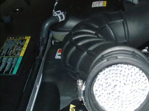

Now we need to figure out what the high RPM HP bottle neck is.
Hydrocarbon trap in 05

Not necessarily. In spite of the link someone provided that said top end HP is important to acceleration, HP is Torque over time. When you are trying to accelerate time is your enemy. The engine's ability to increase RPMs is extremely important, which goes back to why Torque is still more important than HP. Yea, HP is flat from 5,200 - 6,000 RPM, but a flat HP curve tells you that torque is decreasing which means the rate the engine can increase RPMs is decreasing. <--- that concept is important! This is why the 05 owners who are running their cars are telling us that the engine feels flat above 5,500 RPM.
Based on the air-flow characteristics of the 3V heads, all of this data tells me that there is room for significant improvement in the 05, 4.6 - 3V engine. Once the tuners (or owners) figure out exactly what is limiting the 3V's top end, watch out.
