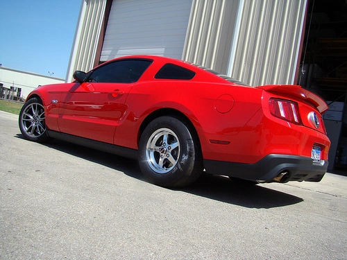

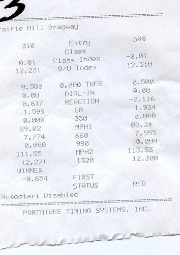

Can't believe I forgot to post this up. Finally found the time to take the 2011 to the local 1/4 mile diggs a couple of weekends ago. The weather conditions were less than optimal. Temp was 94° at 9:30pm (it only cooled to 88° by 12:30am) & D.A. was +2900.
The track was Prairie Hill Dragway, which isn't exactly the best track in the world, but has funtional timing equipment. Scott, the owner of the car, made 3 passes that were pretty impressive for the Texas heat/humidity & the less than optimal track surface. The one that made us drink a celebration beer was a 12.221 @ 111.55mph with a 1.599 60ft.
The car is a manual tranny, Brembo package with 3.73's.
Mods to the car were as follows:
SCT tuner
FRPP lowering Springs
Steeda rear swaybar relocation
15x10" Race Star rear wheels
Mickey Thompson 26x10 ET Drags
Since then, we've added a Hushpower Axle-Back & a Steeda CAI, so hopefully 11's will come in short order!

nice numbers! especially that 60 ft under 2sec
curious how you fit 15" rims over the brembos?! There are very few rims in the 18" size i can fit over mine...15" are completely out the question

We left the stock wheels on the front & used a Steeda Rear Swaybar Relocation on the back to clear the 15x10s. I'm guessing you have a Camaro from your sig; on the Mustang only the front is Brembo, the rears are standard issue.
If someone is cutting 2.0 60ft on a full slick, something is wrong!
