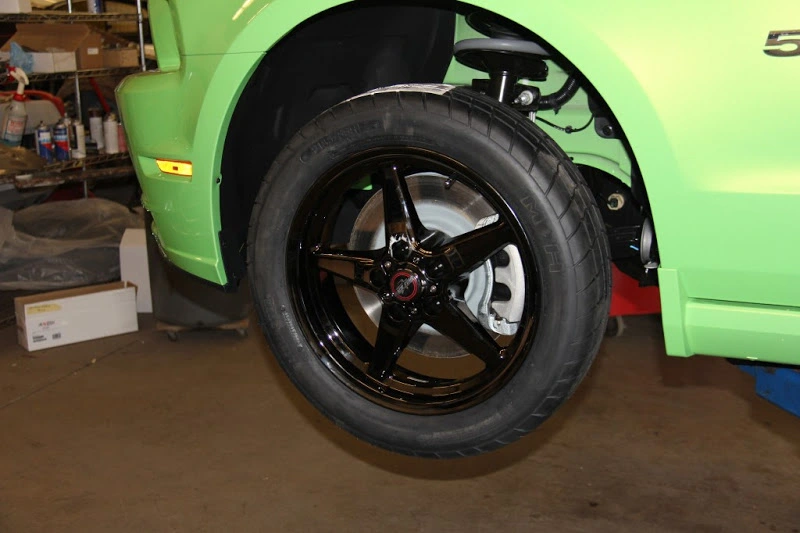

First, the team got to work on the front wheels and tires, which was very easy: Just remove the old and swap in the new!

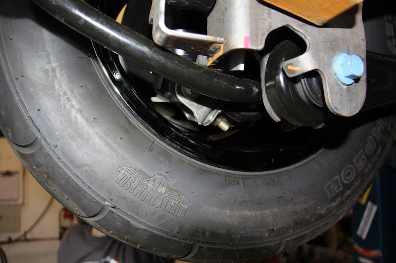

The next task was the BMR Swaybar Relocation Kit. It took a little longer, but with the experience of CJ Pony Service, was no big deal!

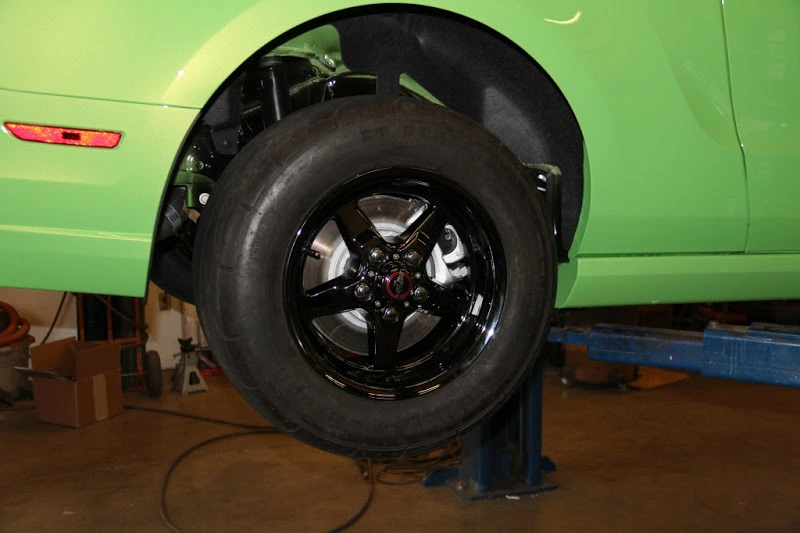

Then, the rear wheels and tires went on:

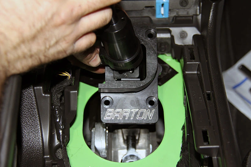

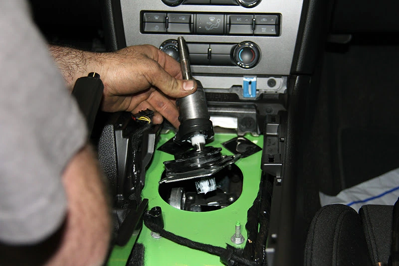

Finally, the Barton Short Throw Shifter and Barton Shifter Bracket were installed:
The stock shifter being removed.
The new Barton Shifter being installed.

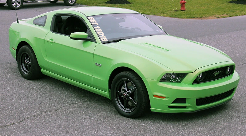

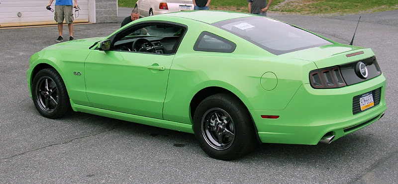

Check out a few shots of the finished product:
We’ll be providing much more detailed videos and blogs on these installs soon, so check back in a week or two when they are ready to go!

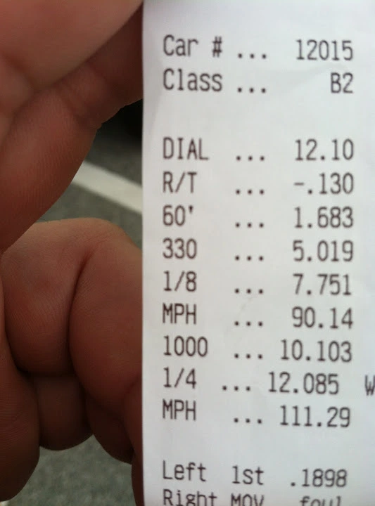

This past weekend the guys were at the NMRA event at MIR. They raced the Gotta Have Race, Gotta Have Street and The Raptor. The Gotta Have Race put down a great 12.08 @ 111 time towards the end of the weekend. Stay tune for more info and video to follow in the next couple of days. Until then here is the time slip.

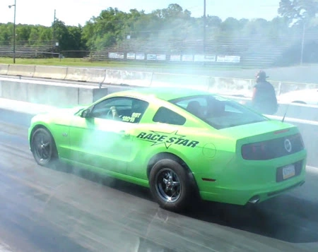

Cecil County Dragway just redid the first 1/8th mile with all new concrete, so this was Bill’s first time racing on the new surface. Not knowing how much bite the track had that early in the morning, the initial plan was for a conservative first pass, but seeing that he had lined up with the customer’s GT500, that plan went out the window and the race was on.

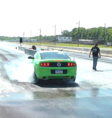

“I did a nice, healthy second gear burnout to put some heat in the drag radials. A line lock has not been installed on the car yet, so I had to do an old school burnout by holding the brakes. I had 24 psi in the rear tires and revved the car to 5000 rpms, same as I did for the 12.08 pass the week before. Unfortunately, the surface wasn’t quite ready for that kind of launch, so Gotta Have it Race blew the tires off pretty badly on launch. The launch has always been tricky with a heavy car, bone stock suspension, and drag radials. You can’t simply dump the clutch; you need to ride it out of the hole a little bit, which puts a lot of heat in the clutch, but has given me a best 60 foot of 1.68 in the past.”
With all of the spin, the 60 foot time was 1.93, but the ET was a promising 12.17 @ 116.32mph. The MPH surprised Bill a lot, as he has always felt that the MPH timers at Cecil were a little on the high side, but the ET doesn’t lie. Bill ran right with the GT500, which was a huge surprise for everyone!
Bill pulled around for a second pass with 22 psi in tires and using the same launch. Gotta Have It Race still spun, but not as badly as the first pass, allowing Bill to have another 12.19 @ 115.51. The car felt clean on that pass, but he felt he could have hit the 2-3 shift a little cleaner and gotten the 11 sec pass the whole team wanted so badly.
After letting the car cool for 15-20 minutes, Bill decided to take it up and try it again. He used the same second gear burnout, except lowered the tire pressure to 20 psi.

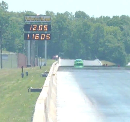

“I left 20 psi in the tires and did my usual 2nd gear burnout, but decided to try 4500 rpm this time and see what happened. The car left the line MUCH better this pass, with no hesitation at all. The 60 foot was 1.74, which is off its best, but still pretty good for our setup. I hit all my shifts cleanly and felt like this might be the 11 second pass we were all was looking for”
Unfortunately, it wasn’t meant to be, as he barely missed the goal with a 12.05 @ 115 mph. Had he been able to get back in the 1.6s with the 60 foot, Gotta Have It Race would have gone into 11’s no problem. The CJ’s team had to leave early so Bill tried to make his next pass immediately, but the clutch issue returned so they called it a day and drove home with a new best.
