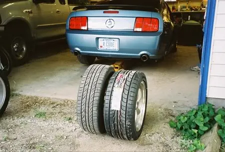

My Goodyear Eagle F1 GS-D3s have arrived (4 x 275/40R18s) before my 18" AFS Mach 1 wheels. After placing one of the tires next to the stock front tire, I'm getting nervous about fitment. Anyone stuck this tire size up front? Any problems? There's plenty of room in the back but the front just looks a bit cramped...
