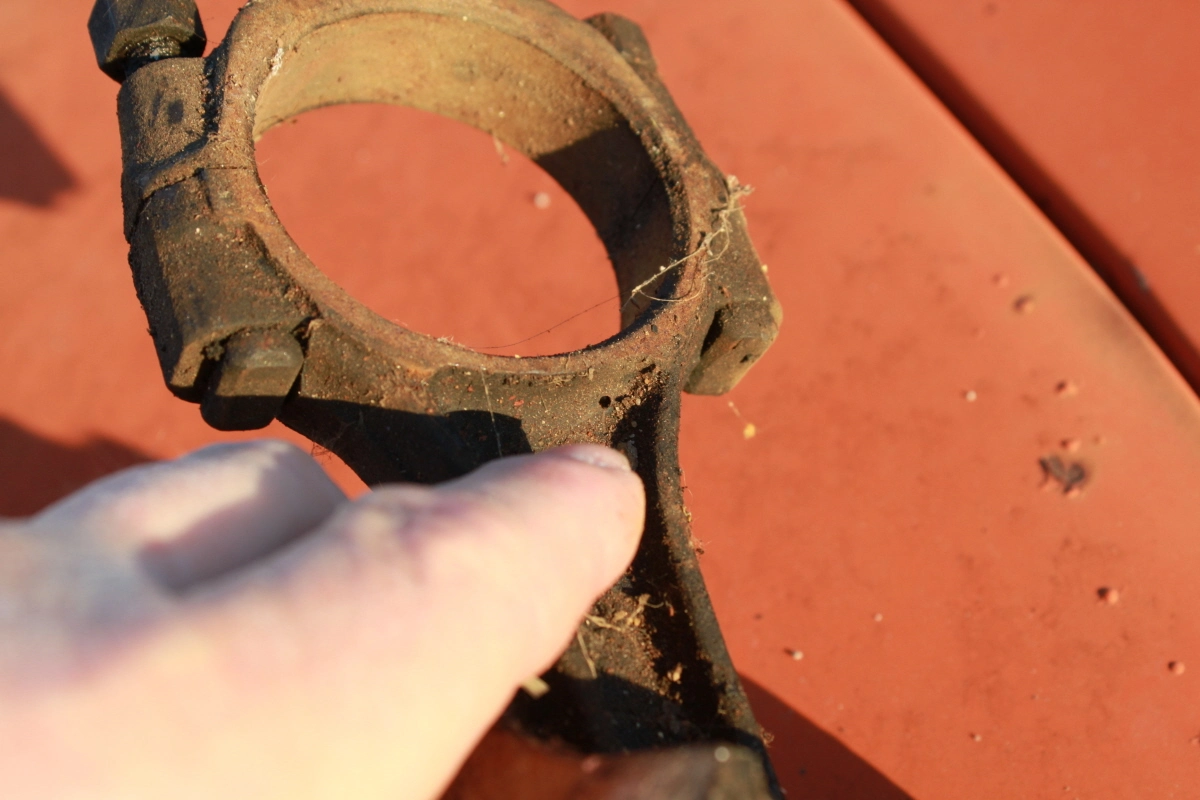

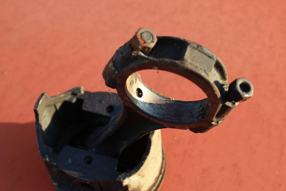

horse sence 15 Year Member Nov 29, 1999 12,509 8,539 233 Wile Coyote's stunt double Jan 1, 2013 #8 Jan 1, 2013 #8 2+2GT said: Got pix? Click to expand... the rods have part -C3AE ,the oiler hole is at the top of the bearing and exits at the base of the I beam. this one is from a 2 V 1965 289
