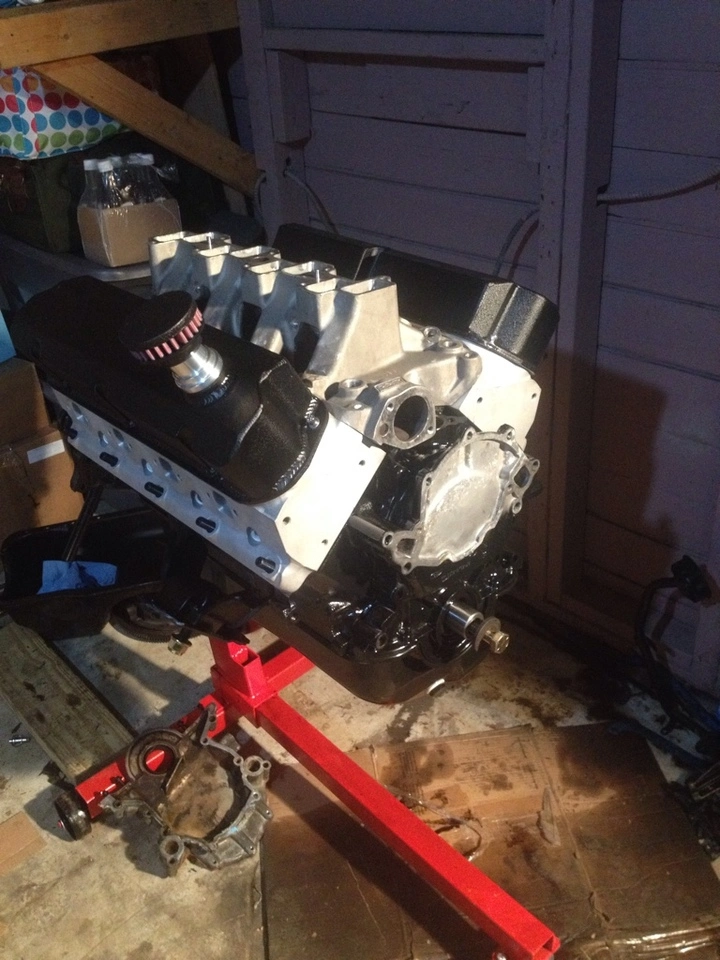

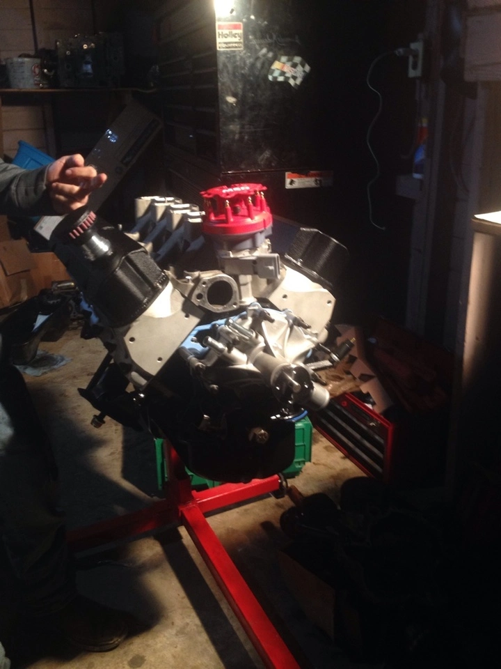

Mar 20, 2016
  • Mar 20, 2016
A5literMan said:
Make sure to follow up with the results. I like to see numbers and find it useful for other people. Good luck on your build!
Will do man! Heres what she looks like as of now
Sent from my iPhone using Tapatalk
