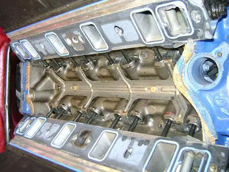

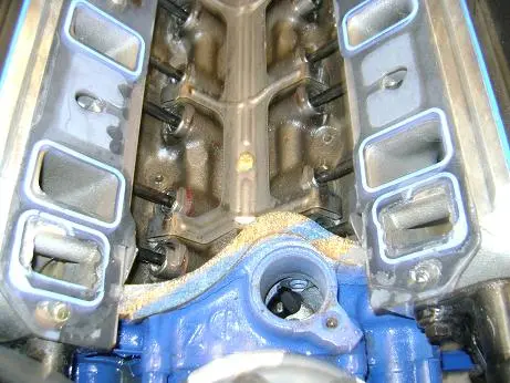

Hey so I got the lower off, about 15 minutes ago, have to get ready for work, I did use that black permatex rtv sealer, it does look like the front shifted, because it is stuck out of place, but not sure if that would cause the water in the oil, anyways I want to make sure I do this right this time, so I will check out every suggestion and take my time with this! I took a few pics and will try to post them!

See in the last pic how the gasket looks shifted, not sure how that could have affected the water ports though?? Don't you think the trick flow street heads should match the trick flow street intake pretty good, compared to lets say a trick flow intake with stock heads. You would think that the same make heads intake would match up better random mixed matched parts?
I got that permatex Right Stuff from Canadian Tire! So I ditched the end corks and used that. I have the intake on there now, just hand tight, and am not tightening till tomorrow morning. I re-read the Trick flow instructions, and it doesn't mention using those cork ends at all, so maybe that was one of my problems right from the getgo, seems like the intake may tighten down a bit more without those cork ends. The trick flow instructions say to use the permatex black rtv sealer on the ends without mention of cork! We'll see how this works! Thanks guys for all the help!
