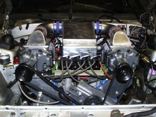

I modified an m90 to fit on my 302, and ive seen a 351 with twin m90's
