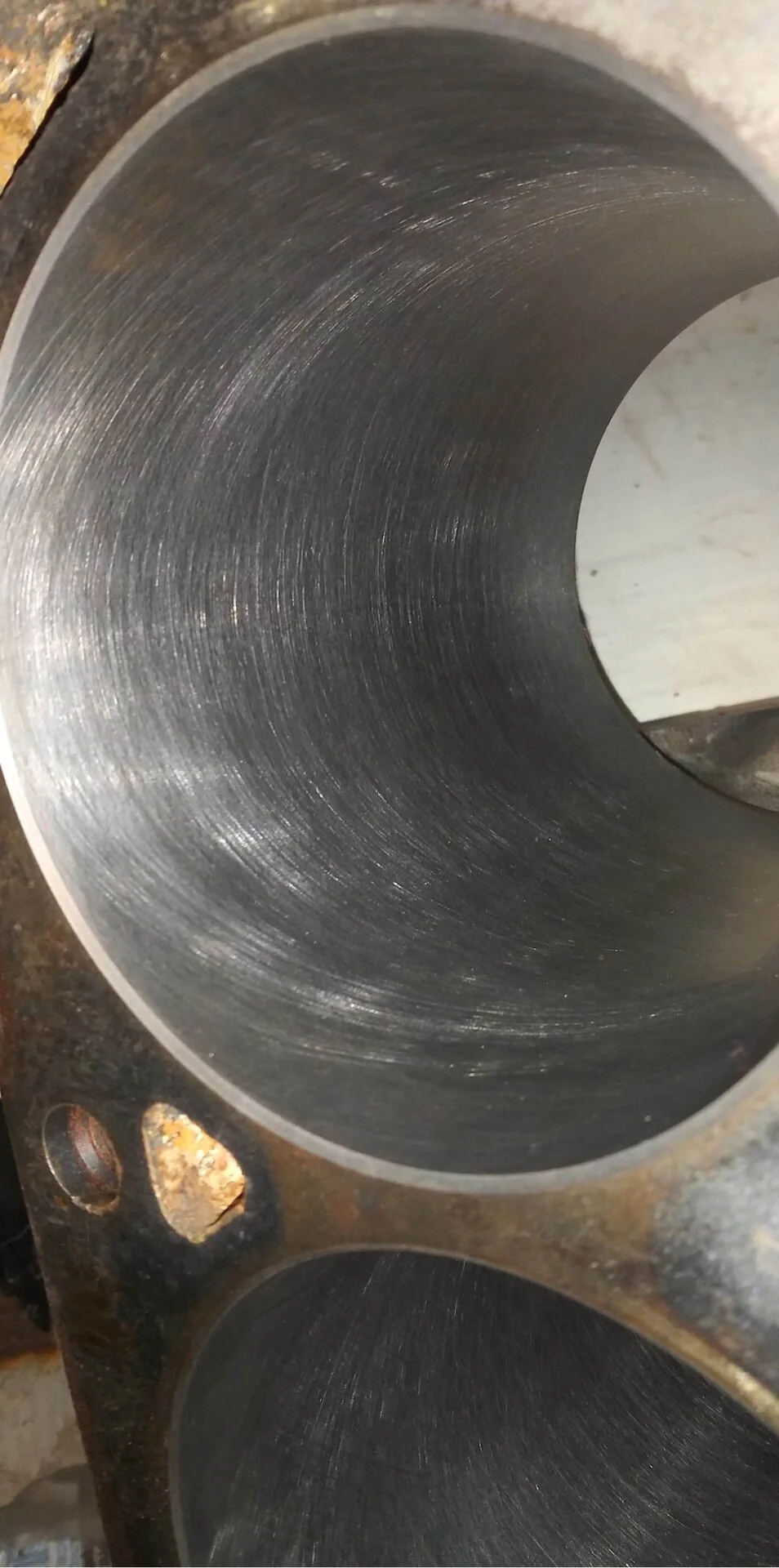

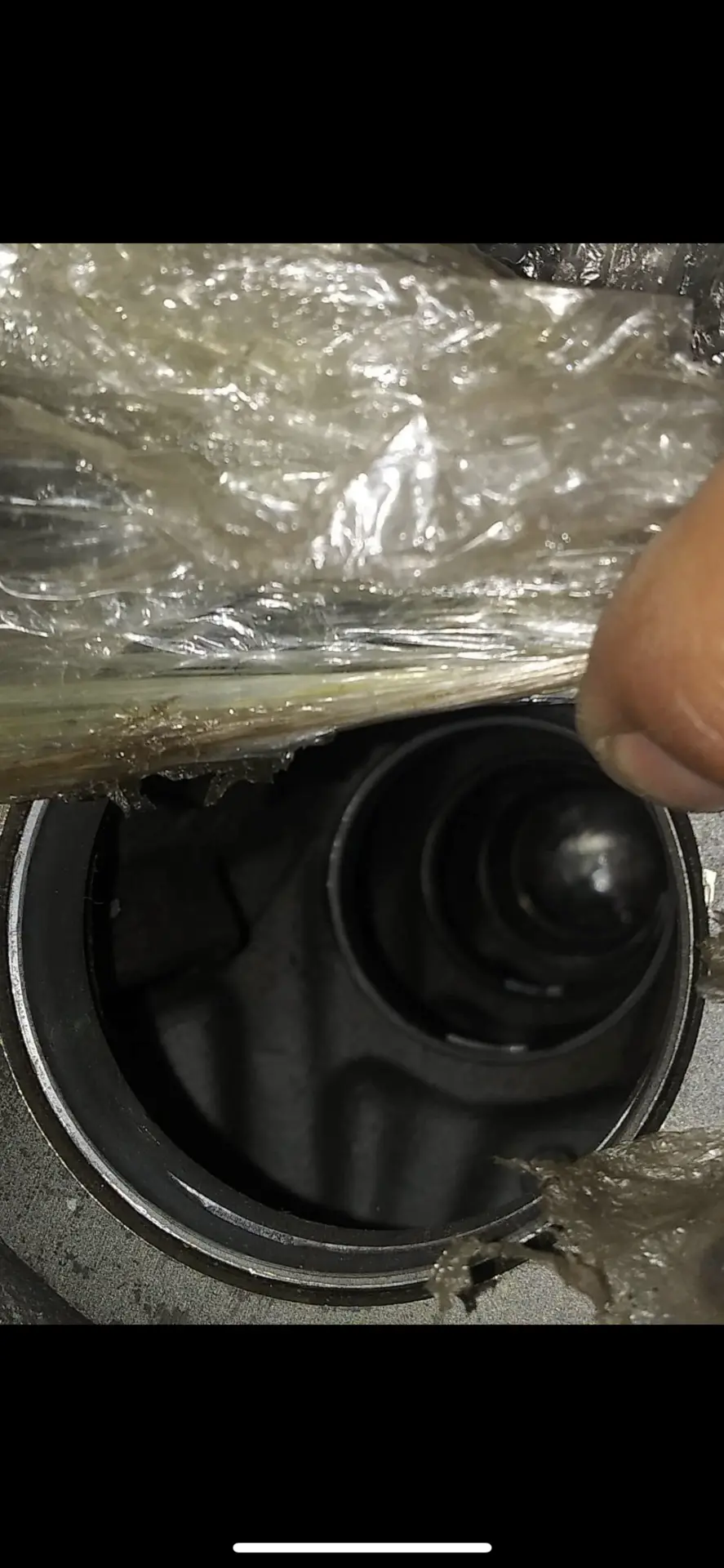

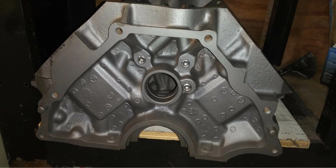

So it’s bored 0.40 currently and he said it was a roller block. I thought it was just a bare block and I would need to buy internals so doing 408 stroke kit from CHP or somewhere was what I was thinking. He just told me he actually has all the original stuff crank, pistons and rods etc that he would toss in with it. So I guess that’s a plus.
Yes that's a roller block so you wouldn't need link bar lifters which are pricey.

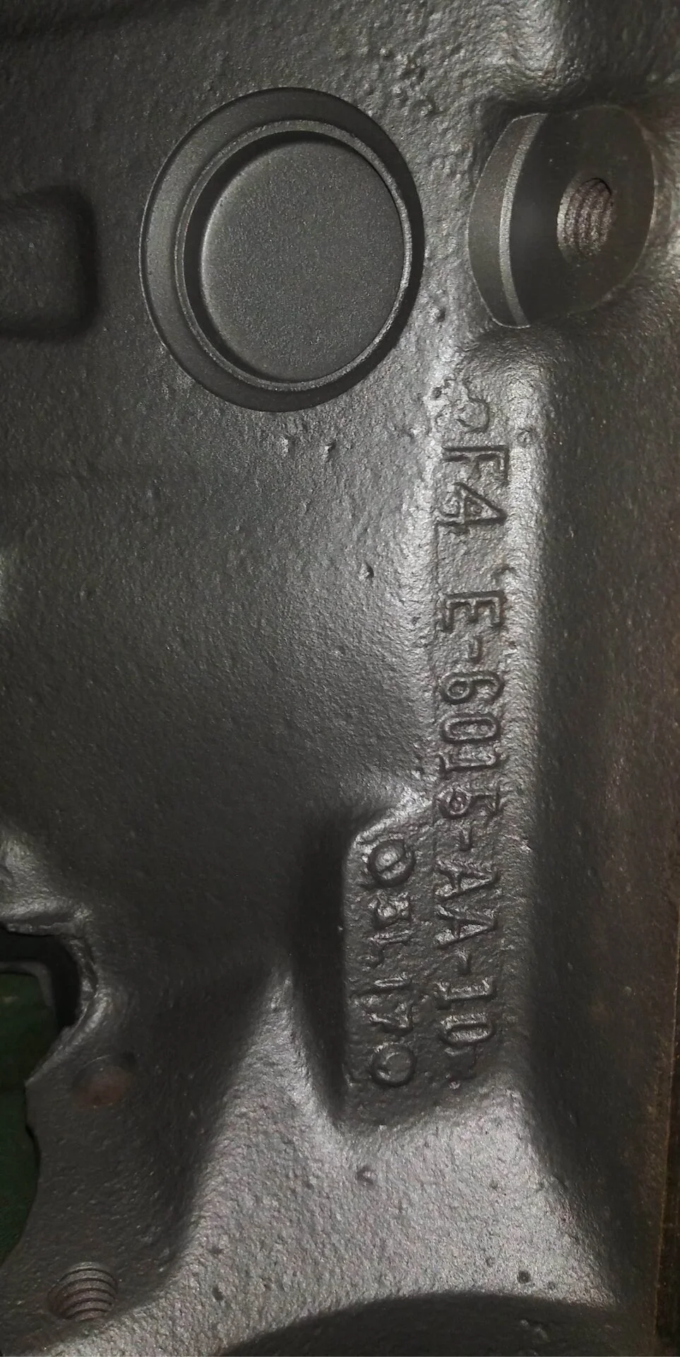

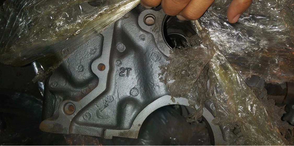

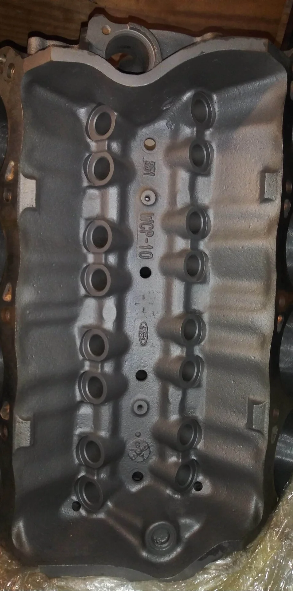

That’s interesting, I got him to snap a pic of the stamp, weird thing is there is no T, is this a stamping issue? I did a quick google and have saw a few topics on this.
The special years you hear people reference is for the roller blocks. I think they were 93-95 with the F4 casting (I know someone will correct me if I am mistaken - and better to have correct information than not).

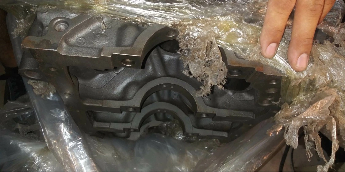

So he said give him $300 for all of it!!! 150 for the block and 150 for machine shop. Plus I get a new engine stand with it and what not, gaskets etc.obky down side is it’s back in my home town and that’s a good 5-6 hour drive south. Guess it’s a good reason to go home visit the parents, hit the beach and grab a motor!
That's a decent deal! I have a fresh 1984 block that's +.030" that I got with a stand for $150, but the guy was in a bind. People argue that the roller blocks are better, but they're also prone to cracking around the cam bearing journals. not all, but some. I think you got a good deal. Put some good heads on it and go to work!
