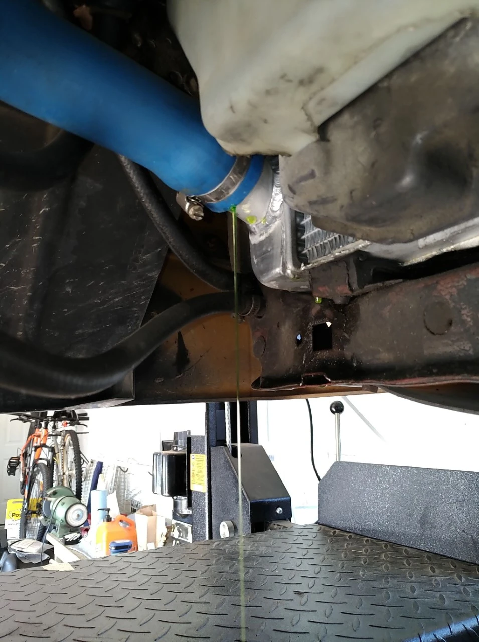

Starting with draining the radiator (no petcock) and removing the exhaust I began with the disassembly.

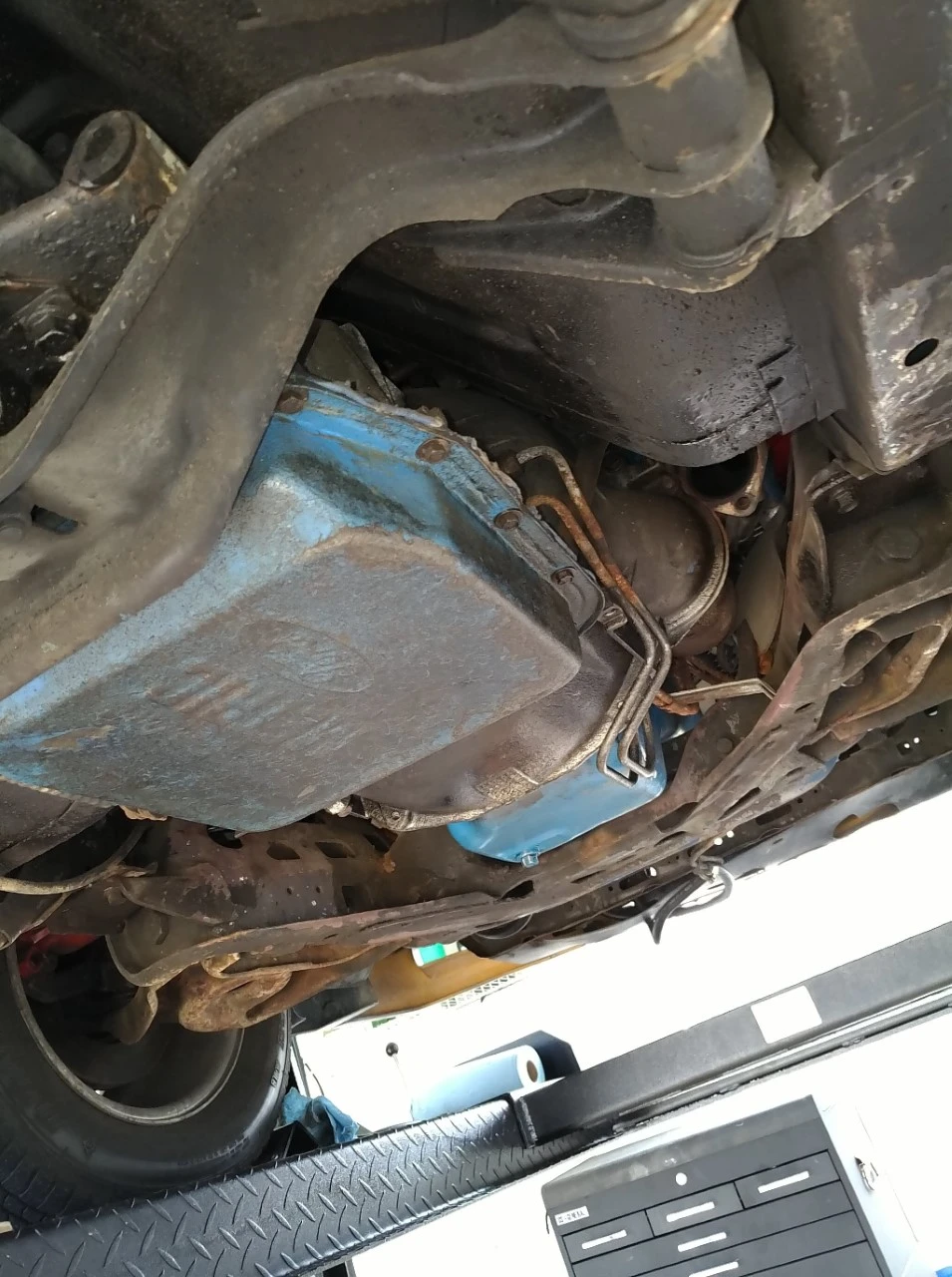

Dirty Old Trans Pan:

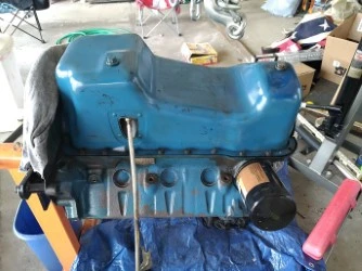

Dirty GT40 crate on the stand:

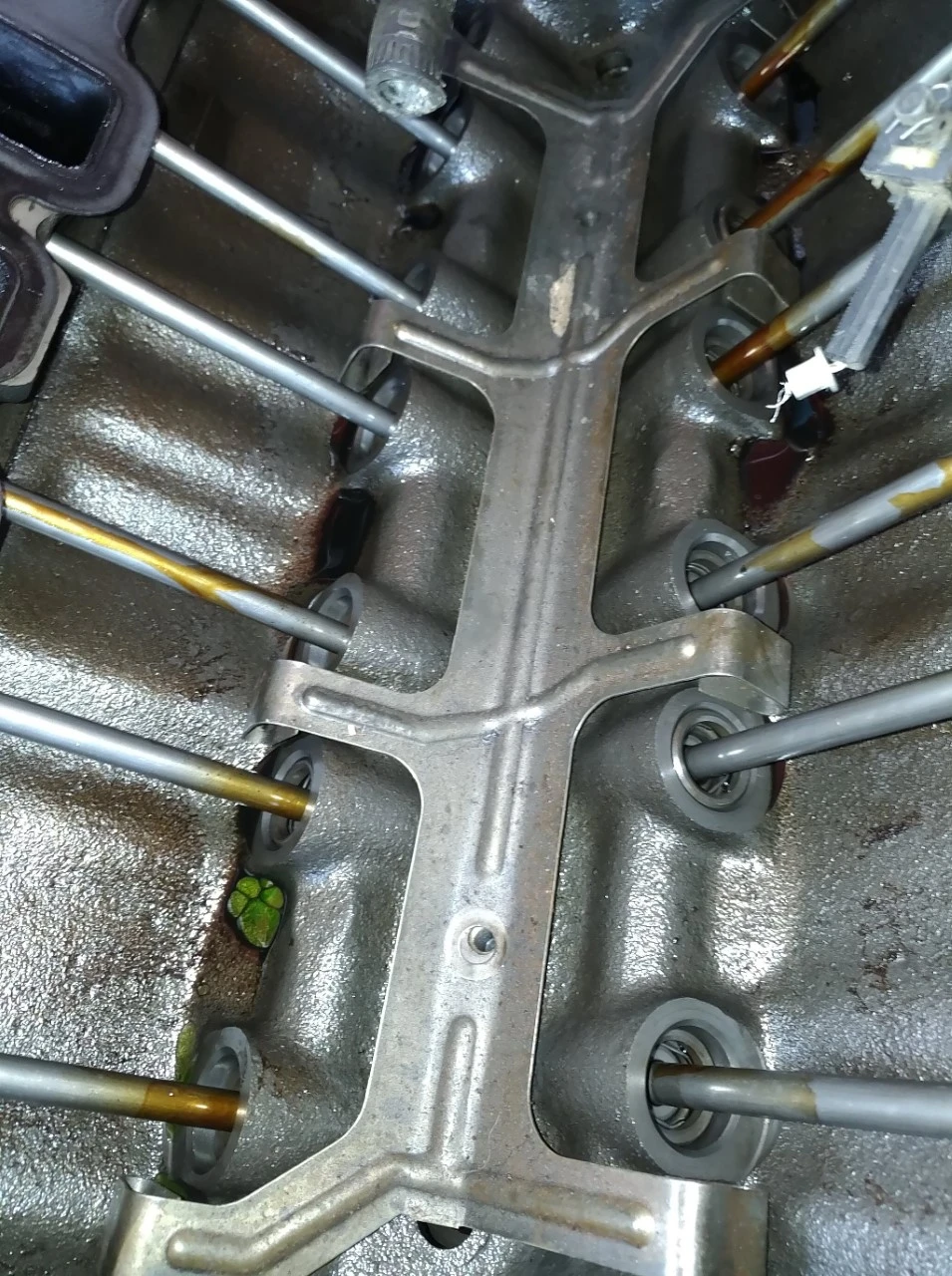

F4TE Blocks are set up for Roller Cam, So the .498 lift cam was replaced by a Comp Cams HE274HR cam

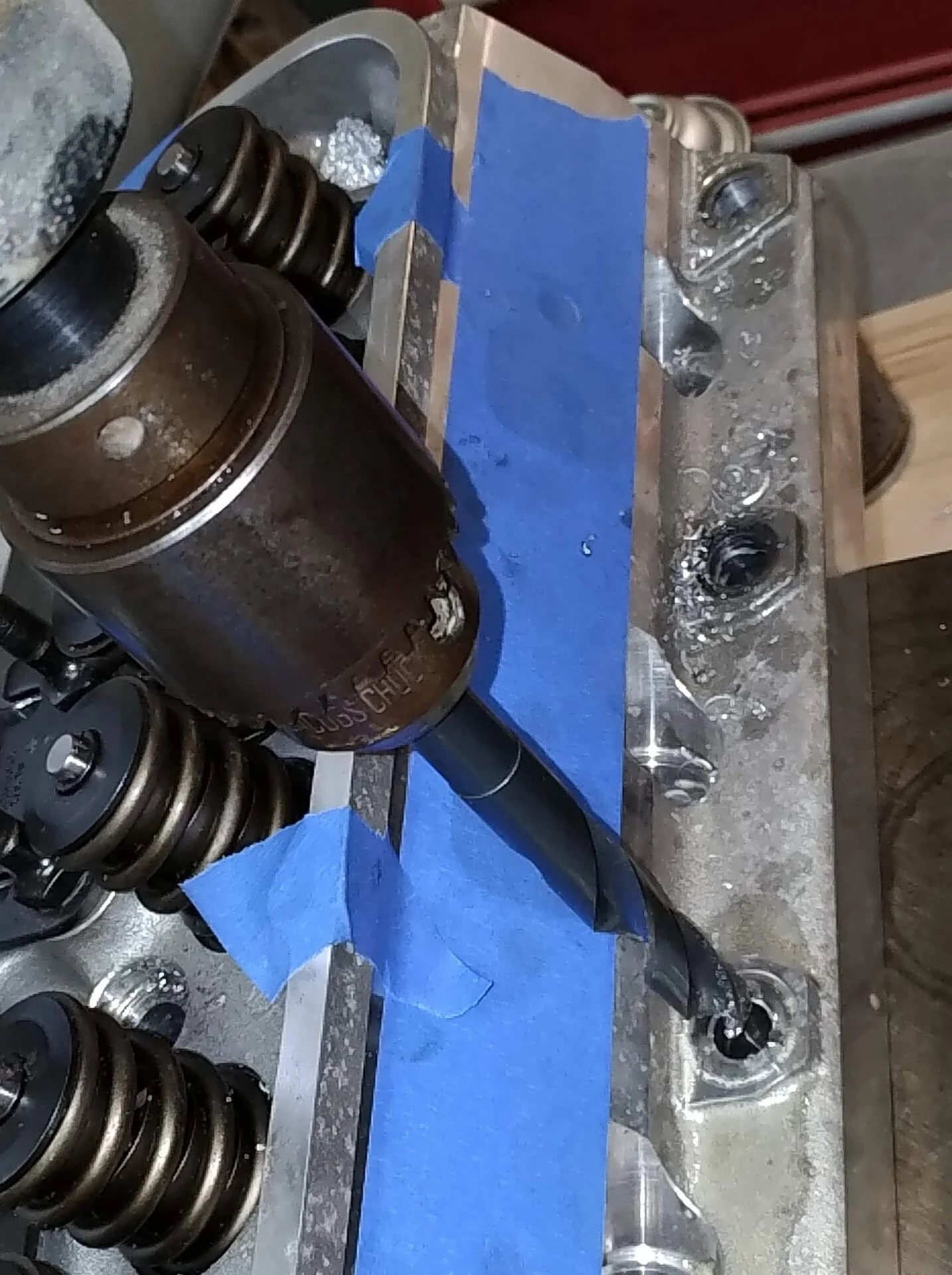

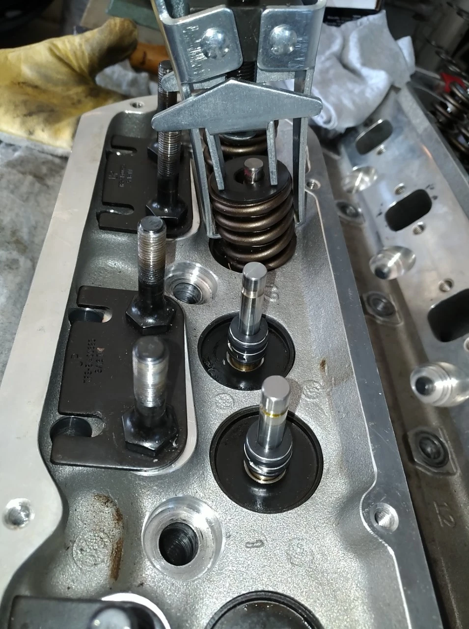

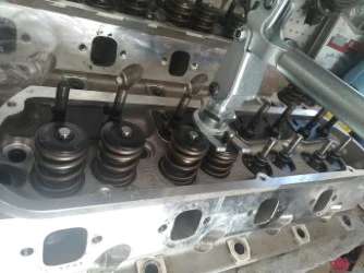

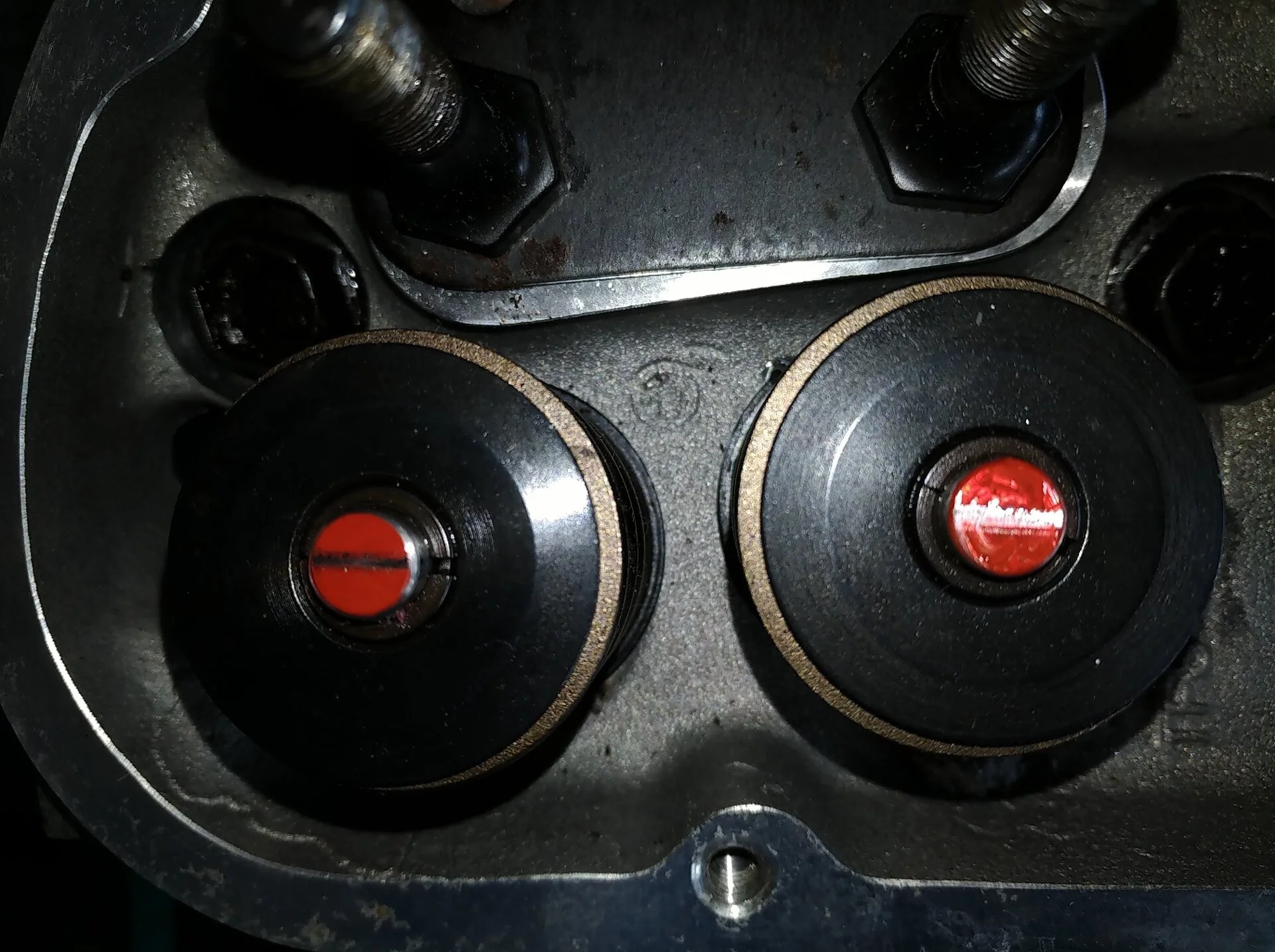

Prepping the TFS Heads - Drilling out the bolt holes for 351W, swapping single springs for double springs

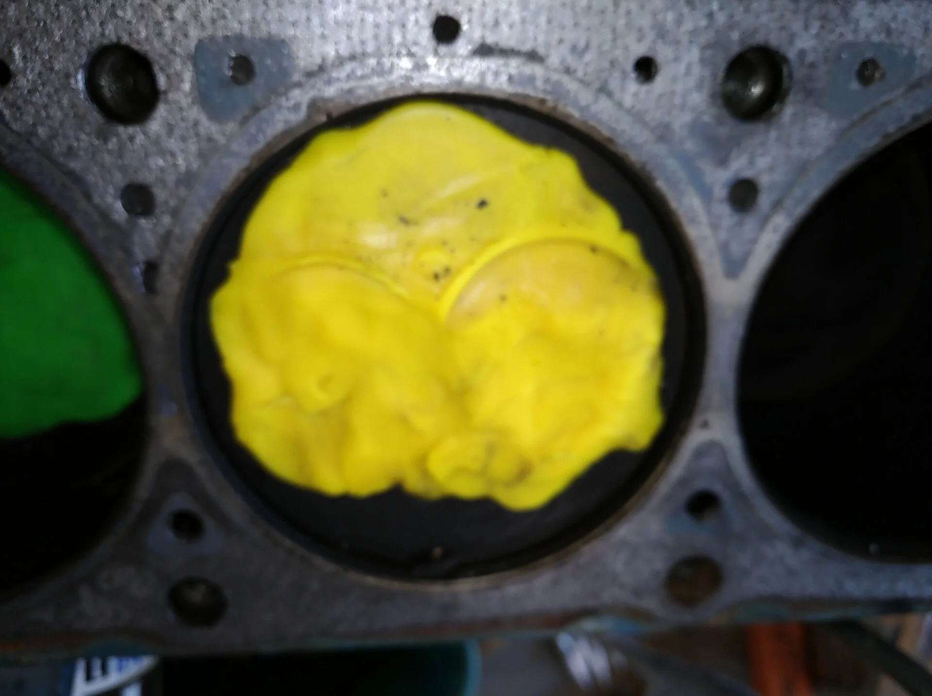

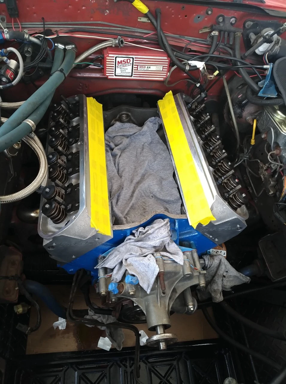

The Roller Cam required a change in pushrods (8.050) and PTV clay test.

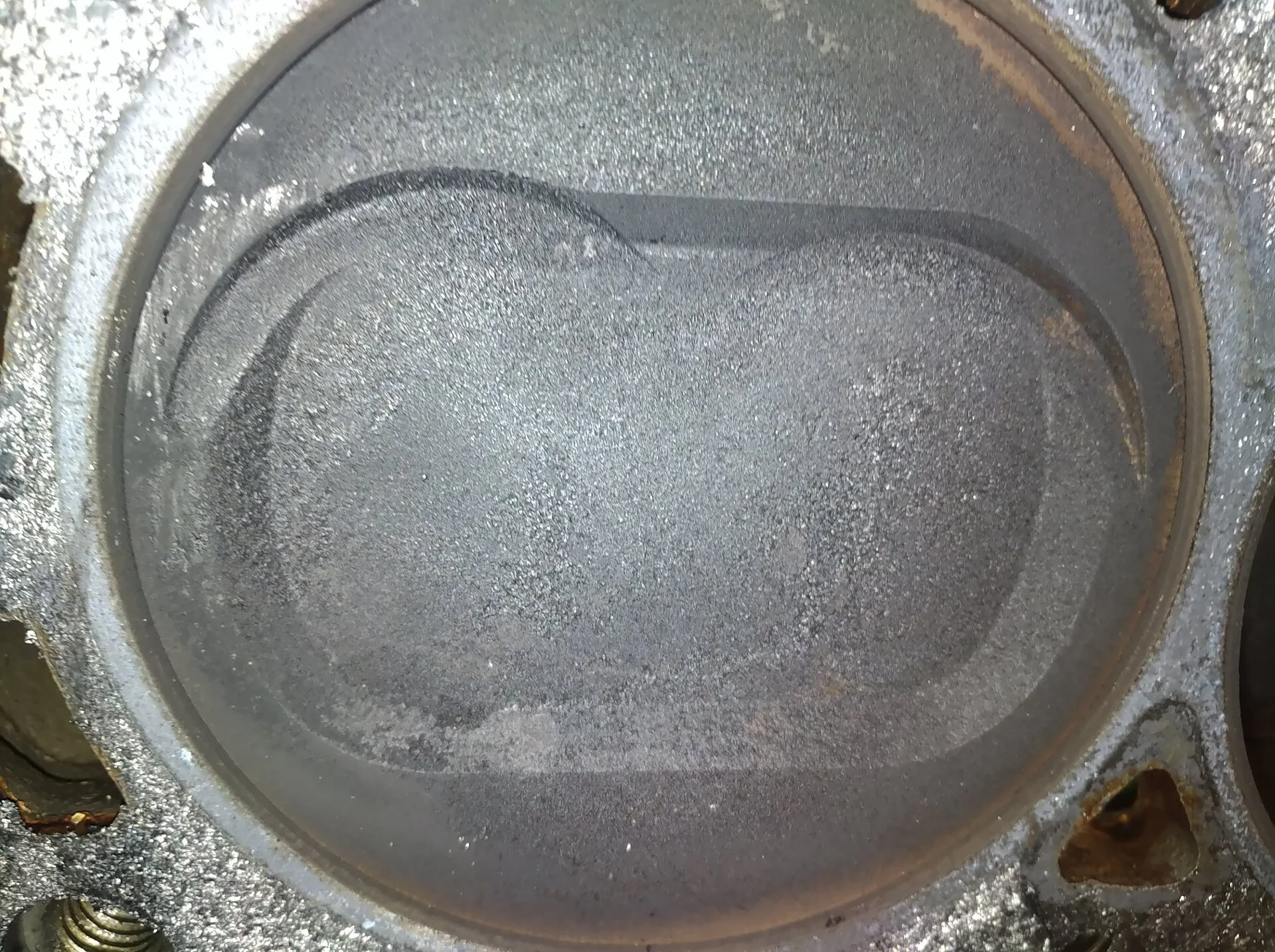

Healthy dish on the 4FTE block

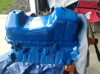

351 scrubbed and painted.

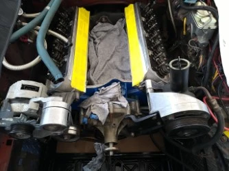

Accessories On:

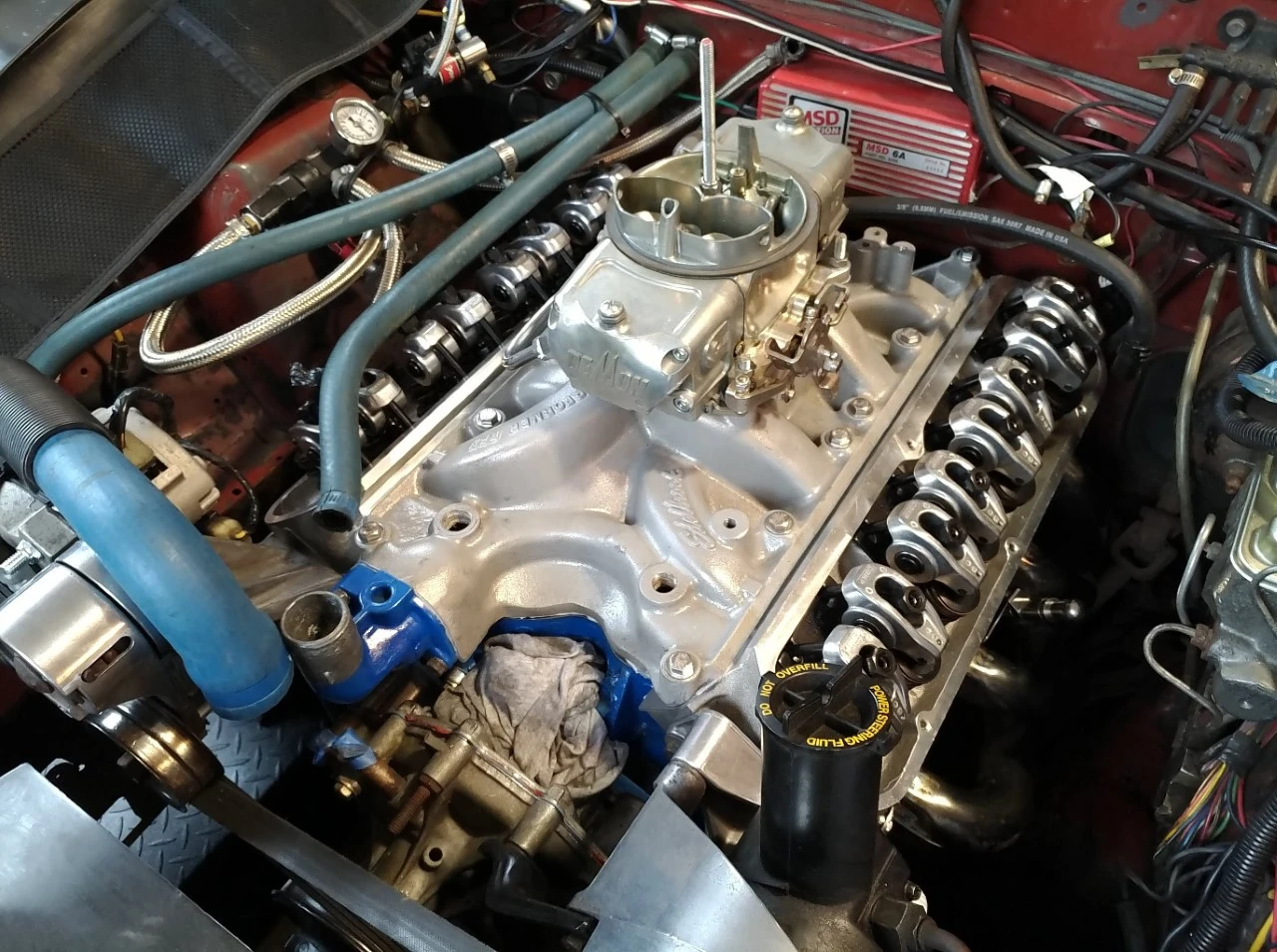

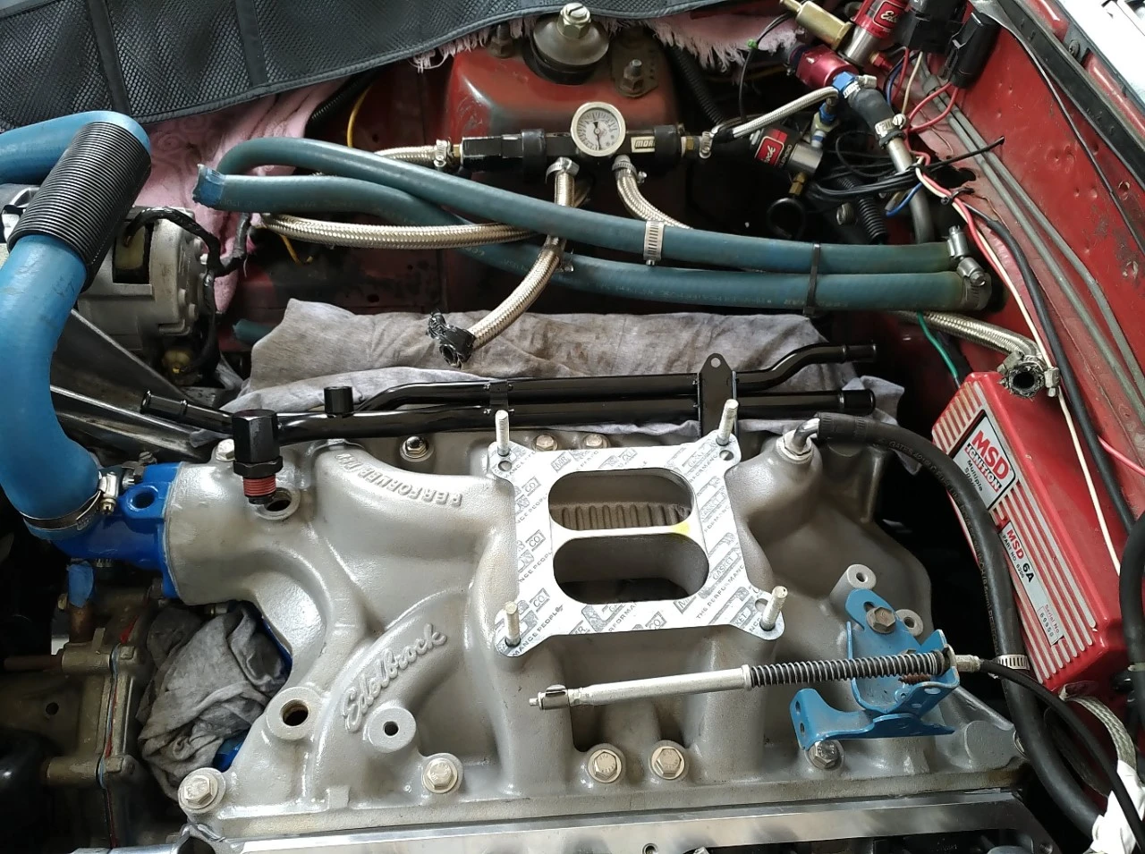

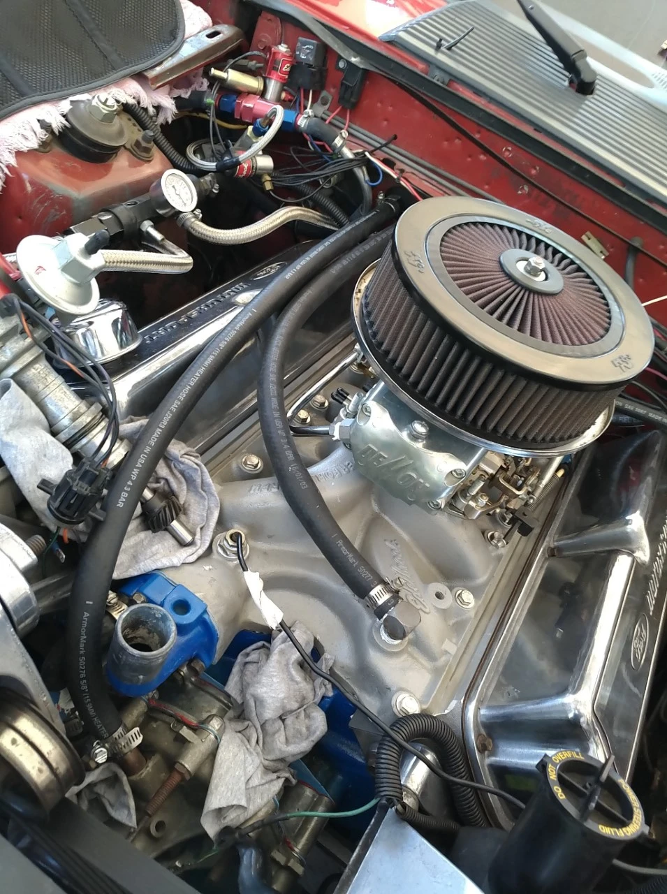

Intake and Carb On:

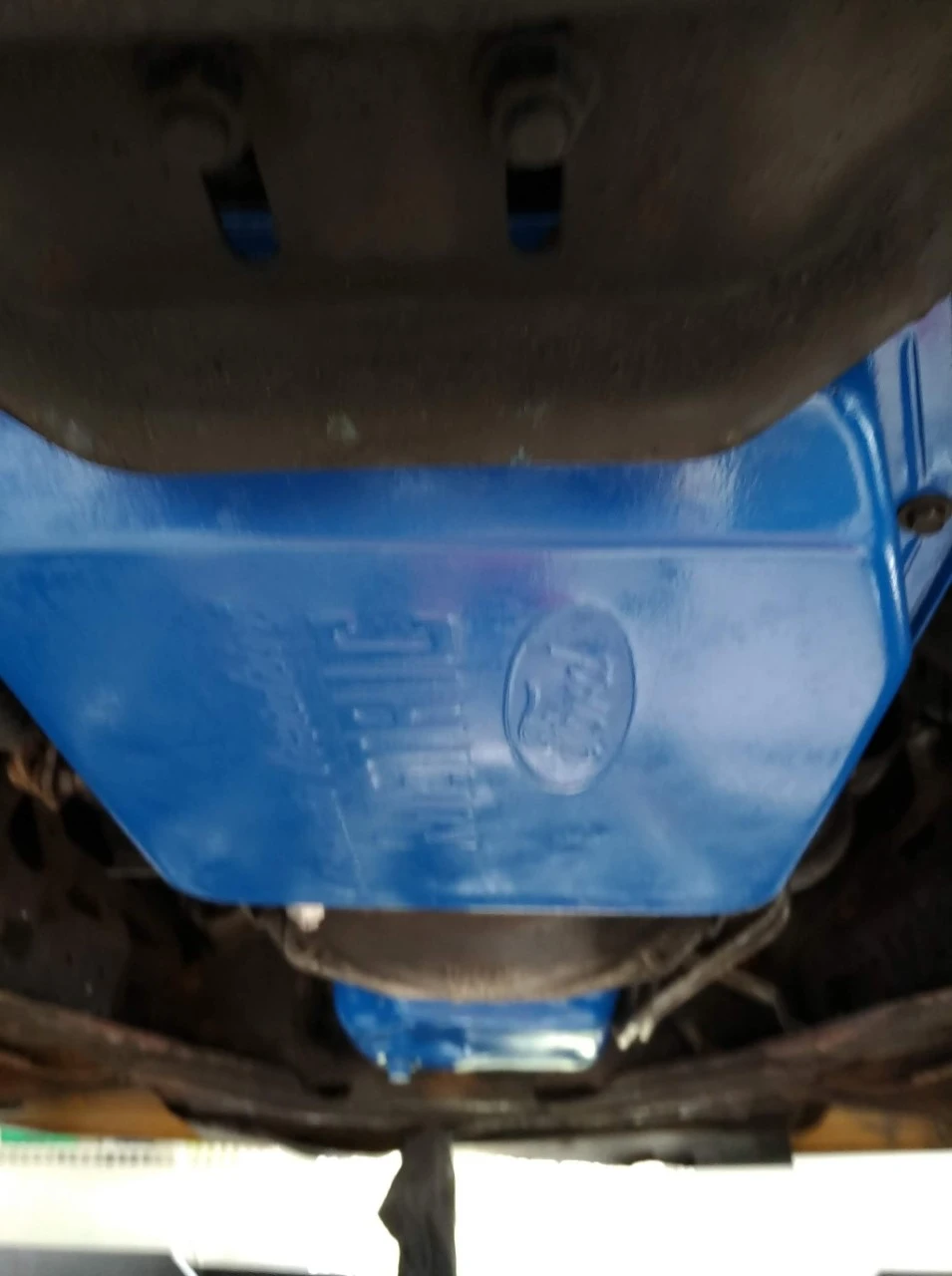

Trans filter and fluid changed while I was at it:

So my covid-19 break allowed for a leisurely 2 month swap. I worked on it when it was warm and when I was in a good mood. It actually starts easier and runs smoother with the roller cam even though I gained a half inch in lift. Car pulls hard and obliterates 225 tires all through 1st and 2nd gear. All in all, a worthwhile swap.
