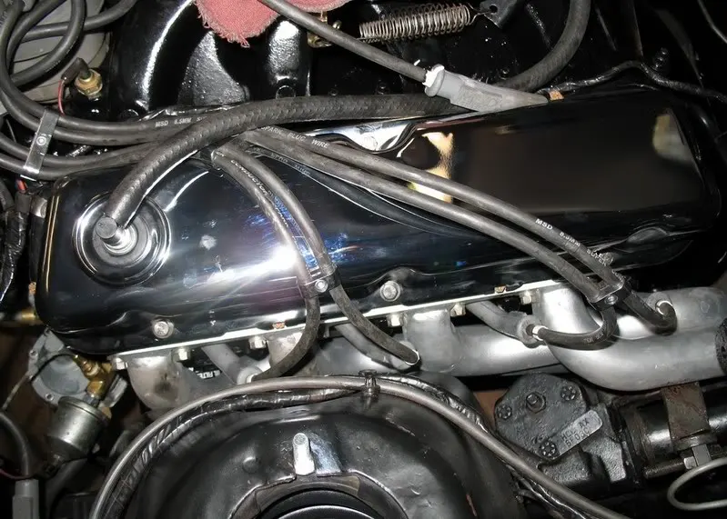

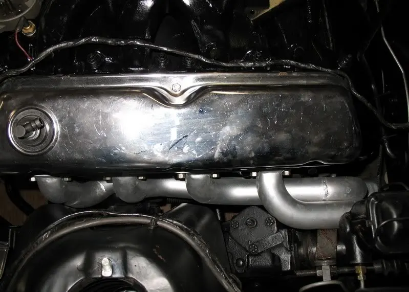

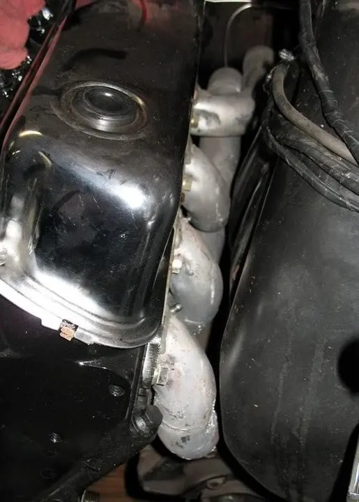

The truth is that there is no readily available 351w swap header that fits perfectly in the 65/66 engine bay. The engine compartment is very narrow and these engines are an afterthought for the very early Mustangs. Each header manufacturer will have its quirks. Some do not cover the 4 speed because there is not much room to bend the tubes to allow for the factory z-bar.
I have used both Tubular Automotive and Accufab headers and know their limitations. The TA's just plain suck for fit. The Accufab's fit OK, but are not the perfect solution. As I said, I doubt that you will find a perfect solution from any of the handfull of manufacturers of the swap headers. It literally takes me 2 hours to remove OR install the Z-bar in my Accufabs. There just isn't much room for 4 header tubes, the engine block, the steering box, and the Z-bar to all route through the same area. The ground clearance I have with my Accufabs borders on phenomenal, so I that is the main reason I recommend them on the forums. I like the fact that although they are hard to install, once in, I can forget that they are there.

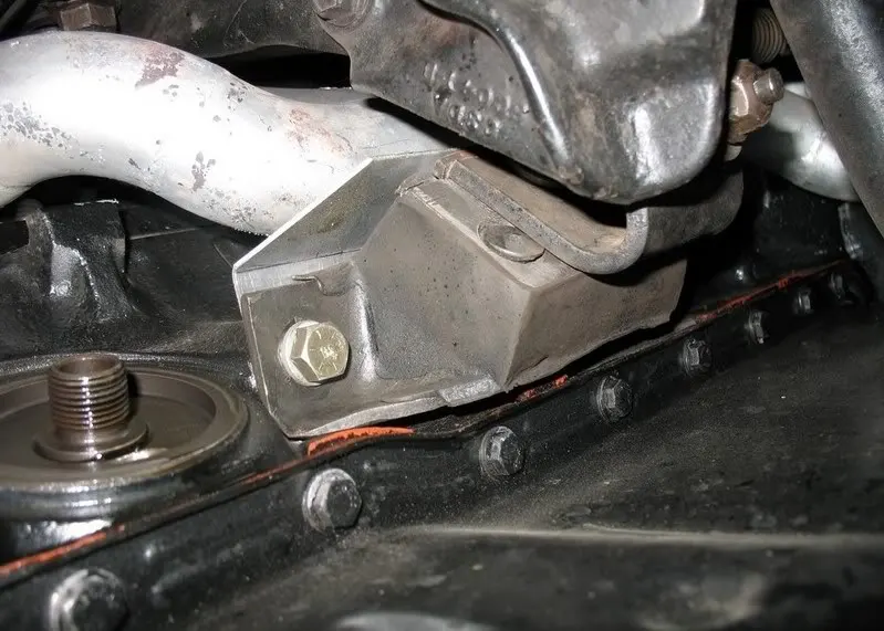

Lets play find my Z-bar:

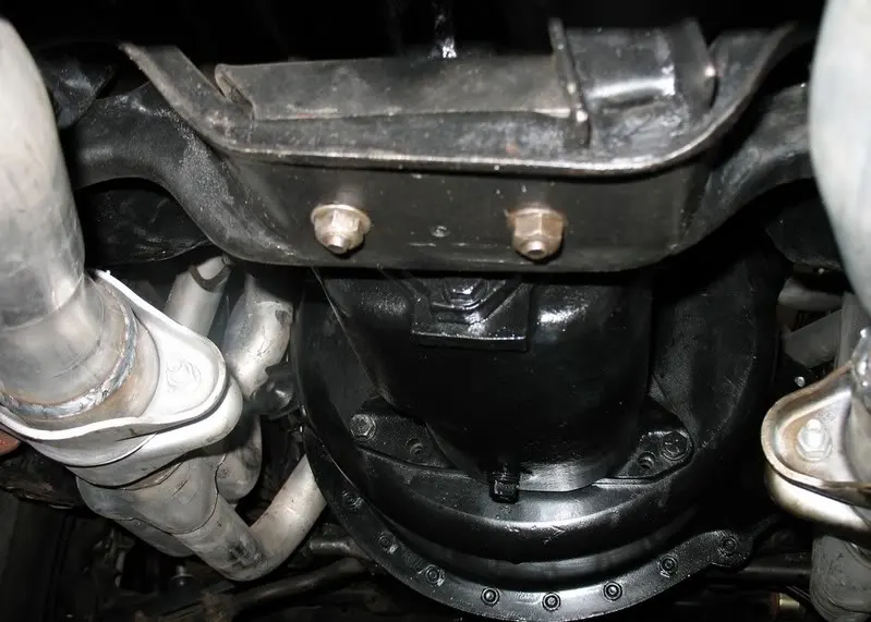

As far as how to check for a 9", if you can place a deep socket on the lower mounting bolts, it is a 8". If there is no way, then you have an 9". The 8" will live for quite awhile behind a 351w or a 347 until you try to install sticky tires. Then a 9" is your friend. Visit Kevinstang's site for some info on 9" ID. Here is one of his pics that show the mounting bolts I mentioned:
Just a correction on that last post, If you can get a deep socket on the bolts pointed out (as in a clear straight shot to them) you have an 8 inch, if you can't (because the housing where the yoke is drops down and is in the way) Then you have a 9 inch. I believe that is a 9 inch in the photo.

Dooh!!!!!!!!!!
Brainfart.
You are correct--a 9" requires removing the lower bolts with a wrench. I have made the correction in my original post to future proof it.

one more addition to the rear end id question, if you have a rear end that looks similar to the one if the photo(that one is a 9" note the scalloped edges) and you can put a socket on the lower two bolts indicated in the picture, then you have a 9 3/8" rear end. the pumpkins will swap though, but just be aware of that.
