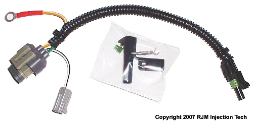

Has anyone here used this. It seems like the way it gets wired is different from the postings here. Just wondering because this looks like a very clean install. It is from Ford Fuel Injection dot com.

The kit is very nice and works well. The kit is designed with less wiring length. We don't wire them up like that normally because we have all the body wiring in the car anyhow.
You can toss that kit in and it will function properly.
You can also make something similar with a new regulator connector and harness.
