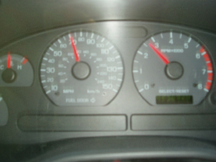

4.10's in an 03 automatic driving in OD at 70 mph. 4.30 would be a bit much unless you are really into racing and don't drive it on the streets that much.
