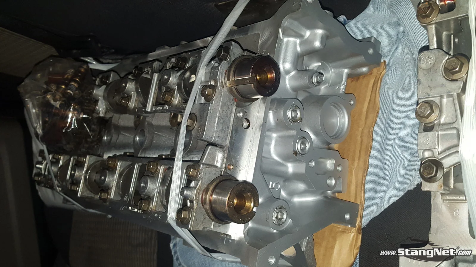

This is my first time posting so forgive me if I don't really do this correctly. I have a 1998 mustang that's been 5.4L 4v v8 swapped with an 8 bolt flywheel and I was wondering what flywheel would bolt up to it? It also has a T45 transmission if that helps.
The only issue you might run into is the difference in clutch diameters. I have a 10 1/2" on my 2v 5.4 but on my 4v 5.4 I went with the 11". just be aware of this when sourcing a new wheel.
2001 Cobra flywheel is what I used.
