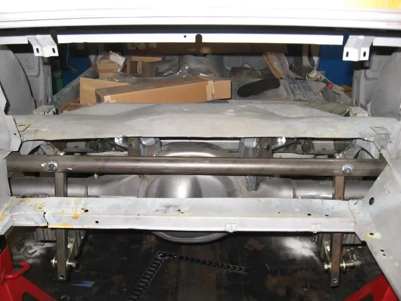

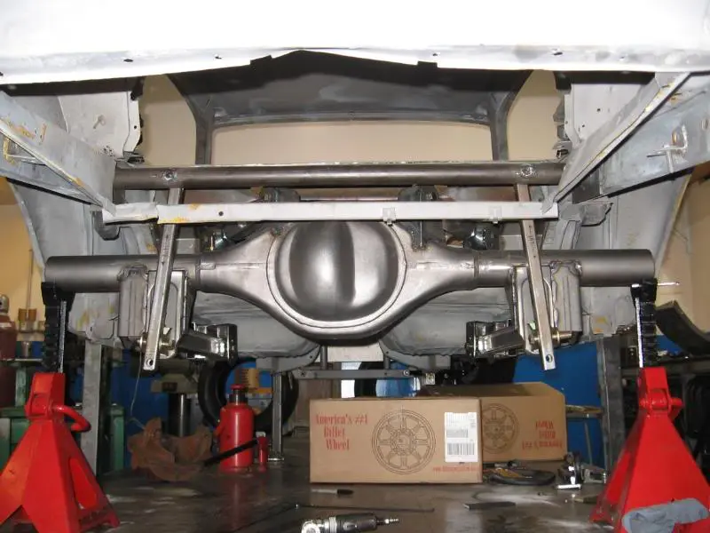

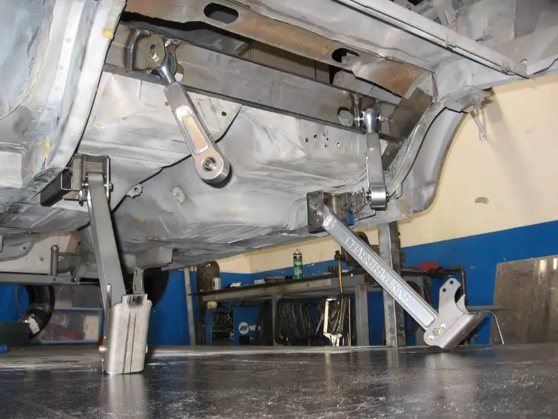

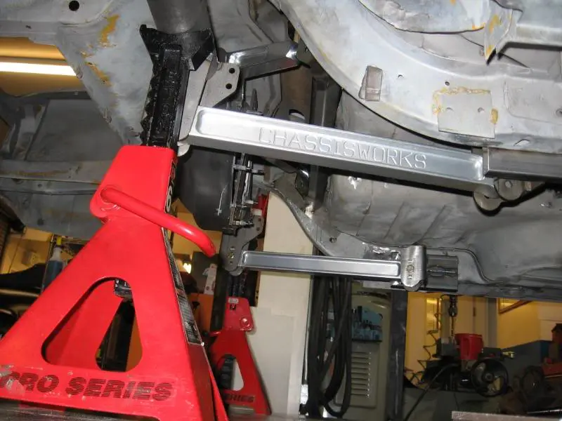

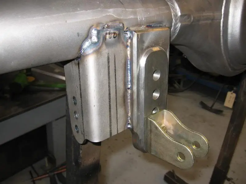

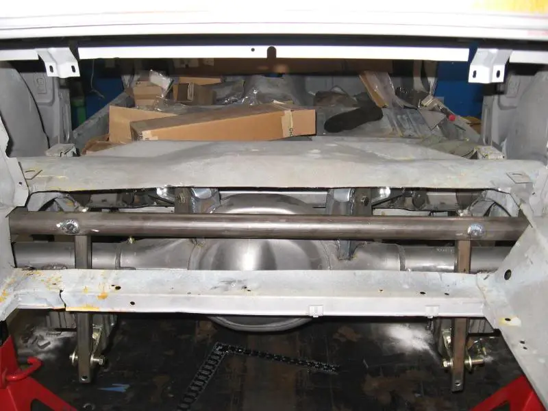

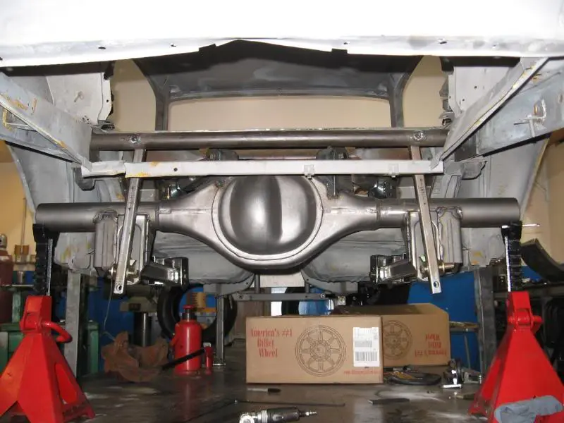

I finnally got all the rear suspension mocked up and its starting to take shape. All the brakets are on and its time to start final welding everything in place

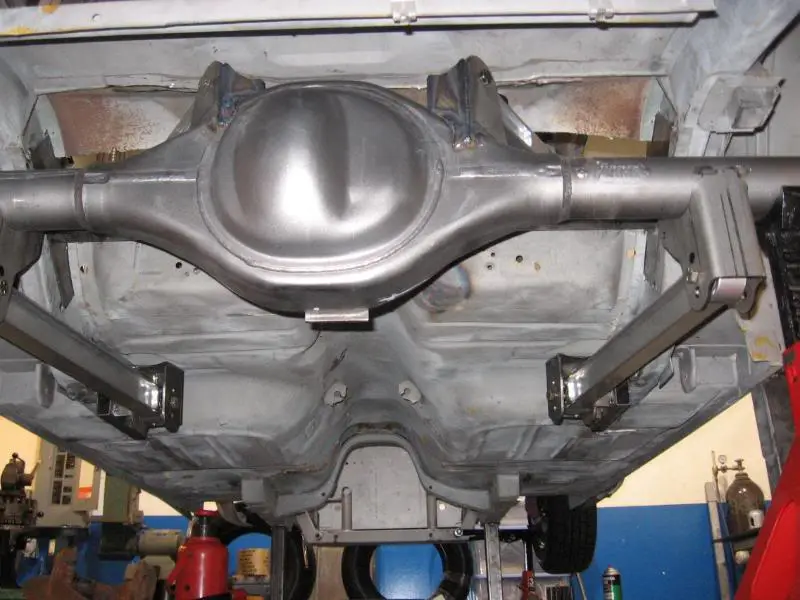

it is a chassisworks universal billet 4 bar kit that I adaapted to fit the mustang. It is similar to the TCP 4 bar but i was able to put the lower control arms inside the frame rail so I can mini tub it later.

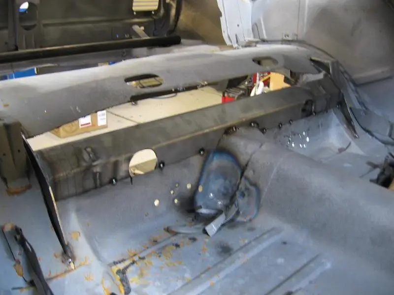

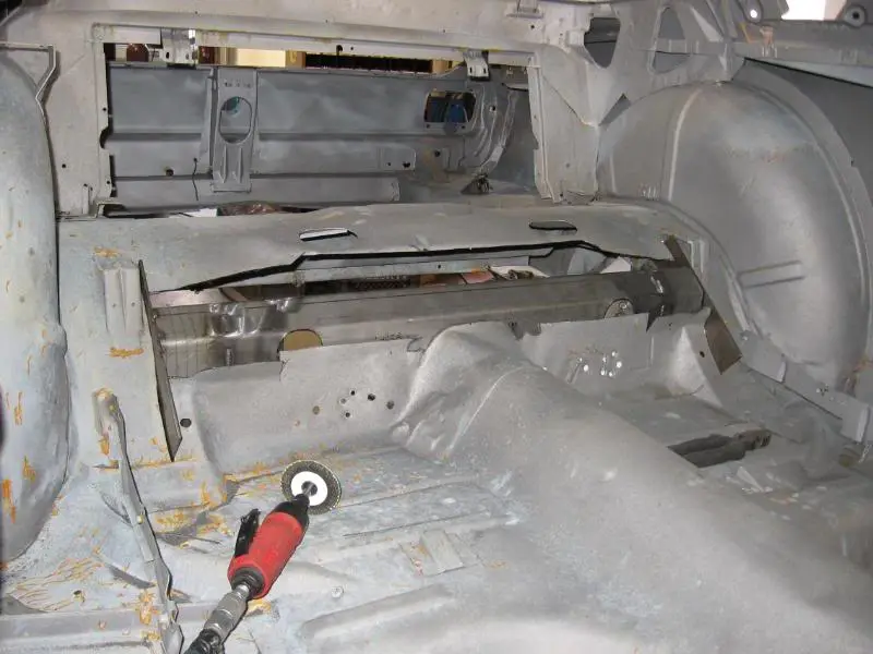

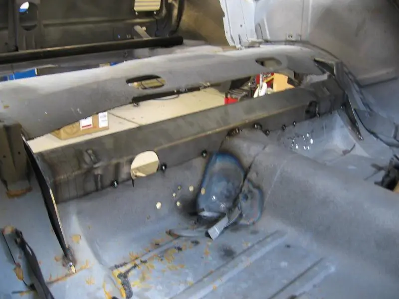

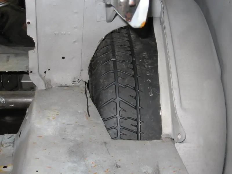

so far it looks like I will be able to fit a 275/50/15 with room to spare while still being able to keep the fold down seat and the interior panels intack. It is just going to take a little creativeness to get the lower part of the rear seat to fit here is a pic from the inside.

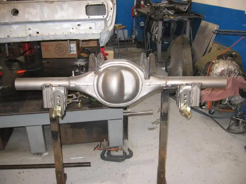

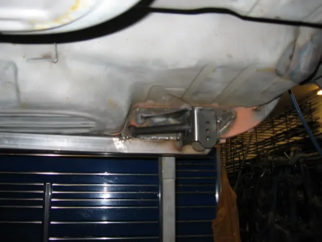

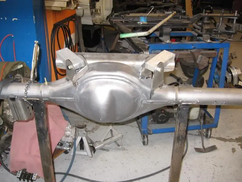

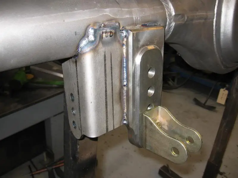

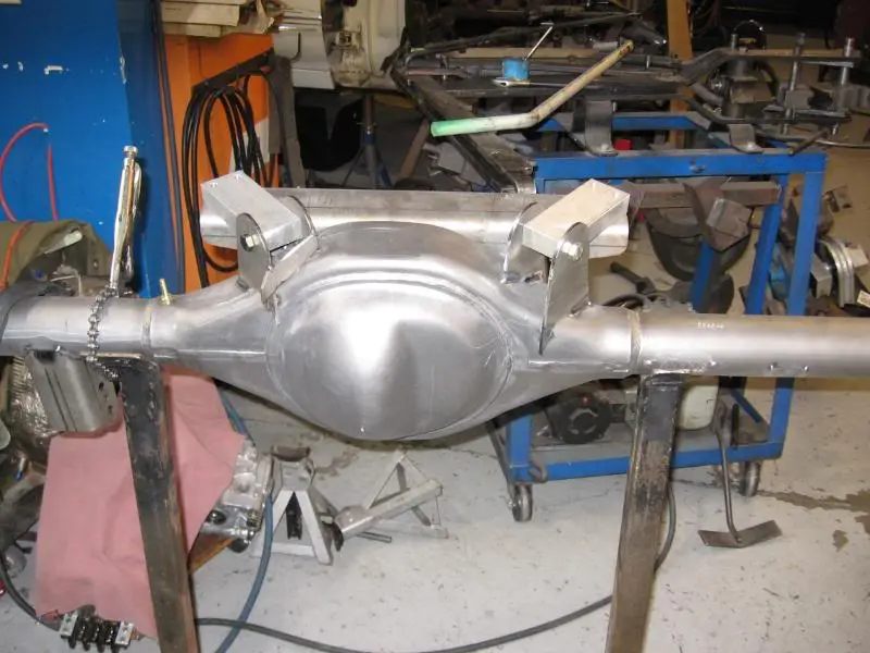

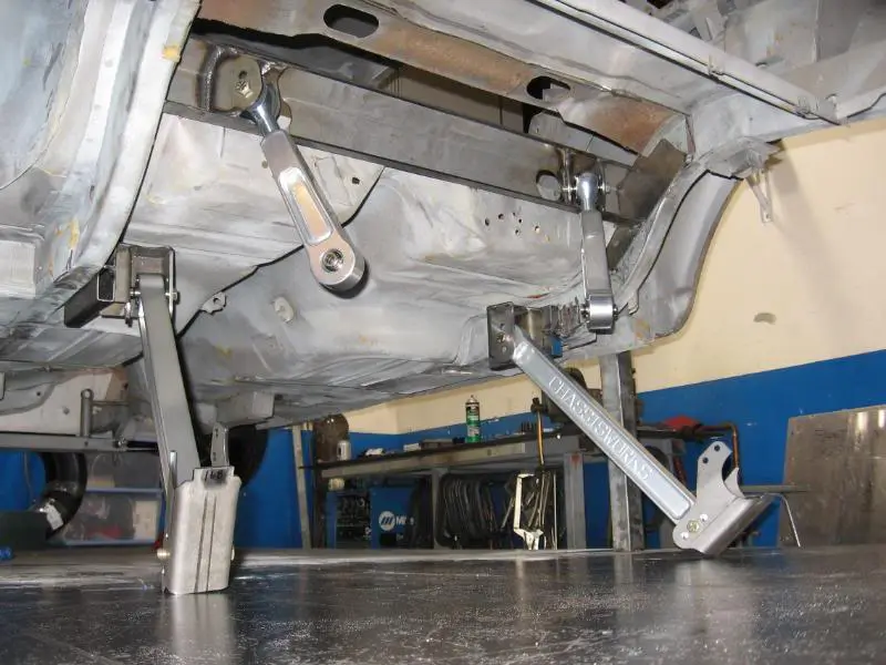

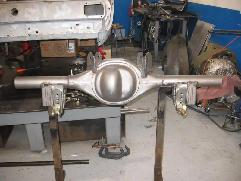

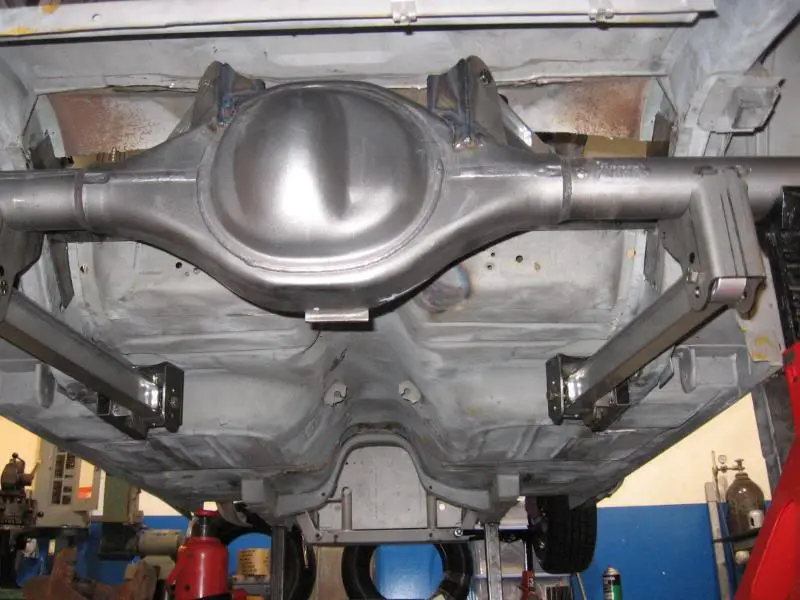

Finally got some more work done on the rear suspension today. Was able to get all the brakets welded on the housing and the rear shock crossmember up in place. Now all I have to do is start welding it all together and get my wheels and tires mounted.
here are some more pics

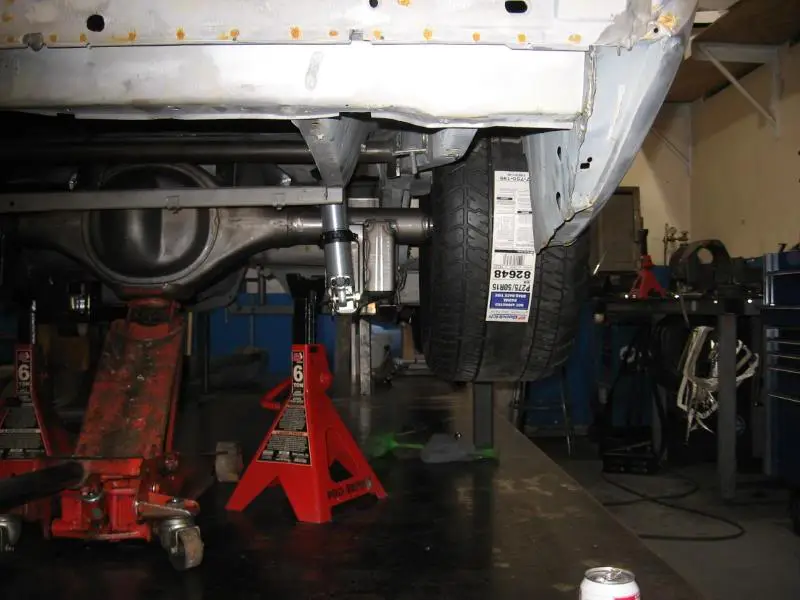

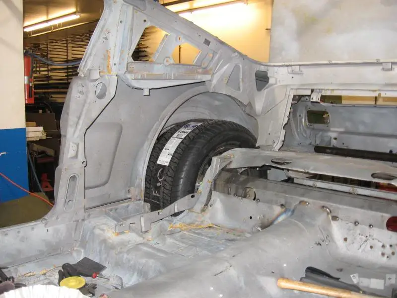

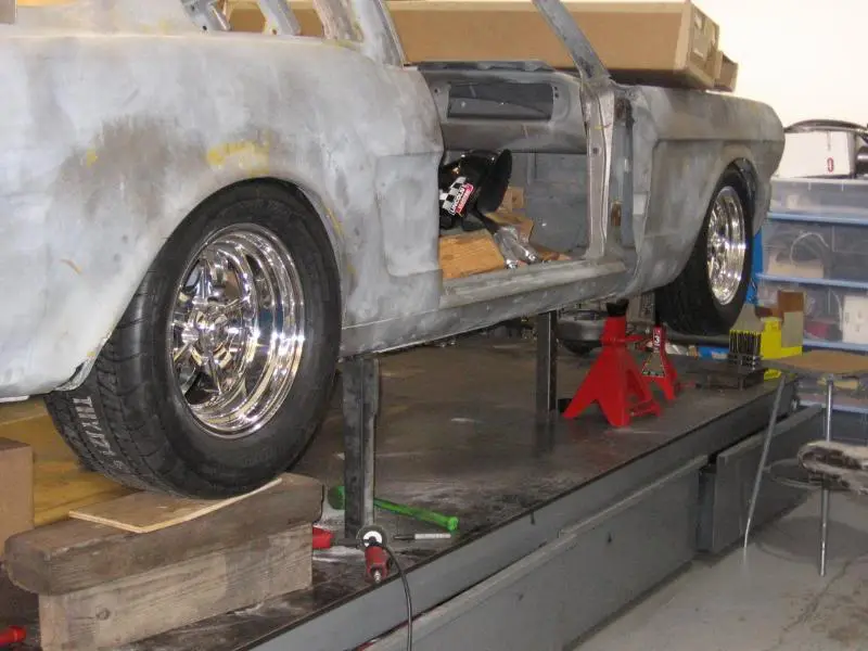

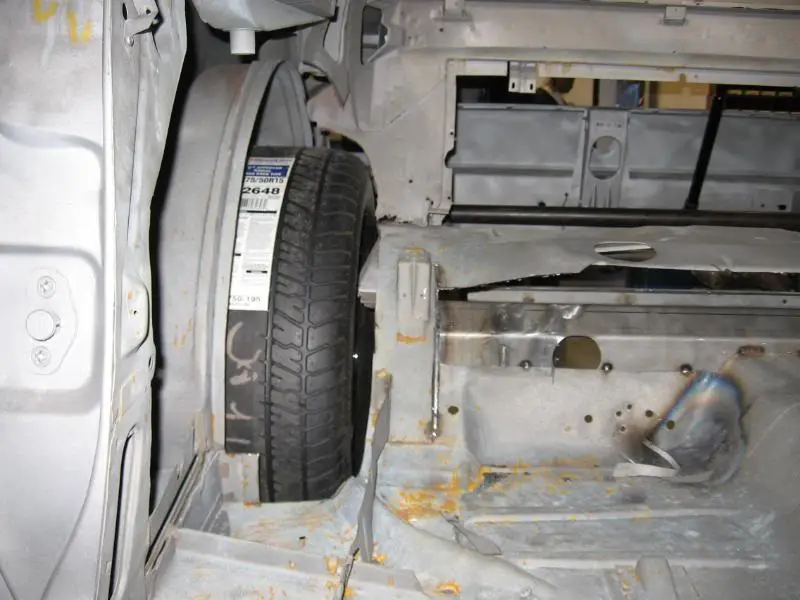

Wheel and tire mocked up
Today I was able to get the wheel tub cut out and the wheel and tire mocked up in there. Looks like with a little trimming it will go in with out a fight and ill be able to run the car with a low ride hight. The rear tire is a 275/50/15 on a 8 inch rim.
hopefully soon i will be able to ge the other side cut out and measure for axel width

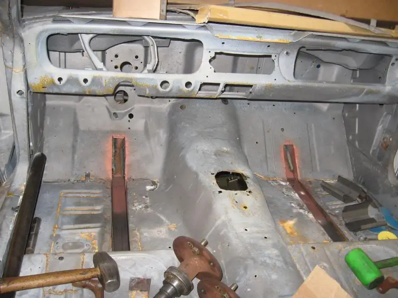

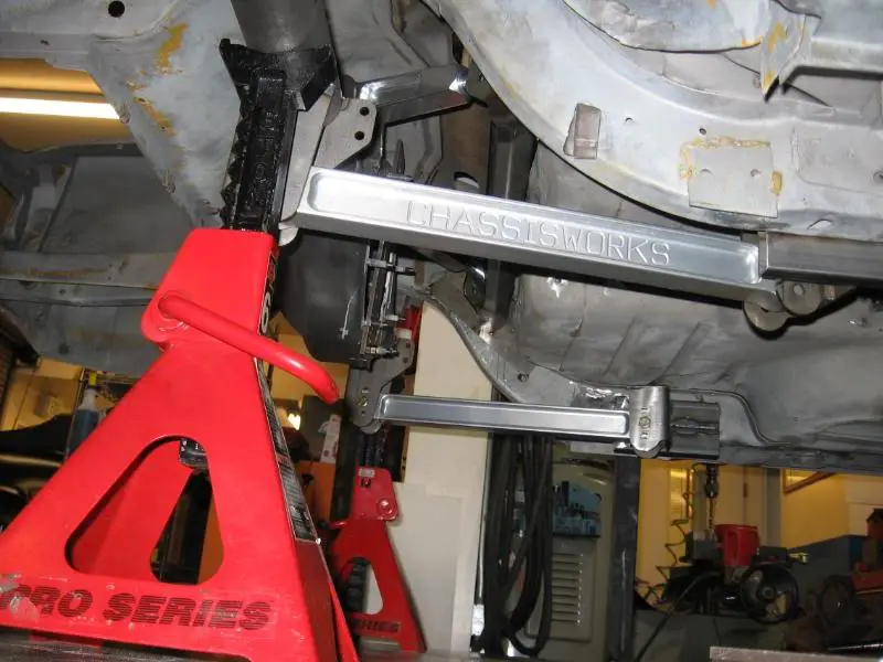

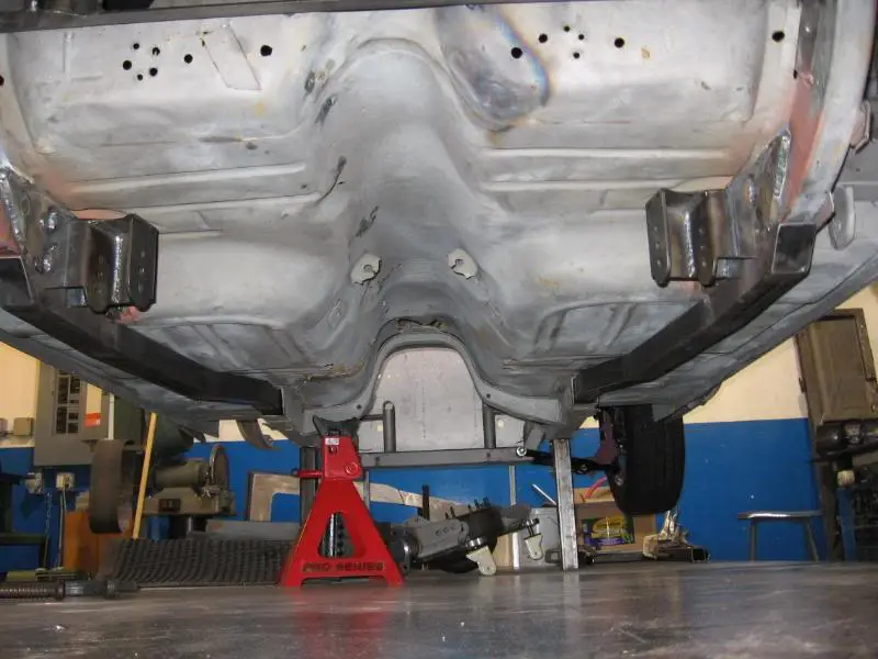

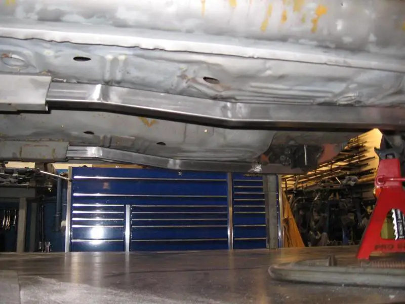

Subframe conectors done and rear end finished
Got the sub frame connectors done over the weekend. Decided to run them all the way up to the front frame rail. Also finsished the rear end housing. Just a matter of time before the car can come off the jig and start doing sheet metal.
here are some new pics

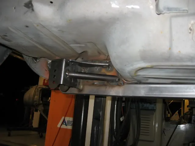

No There is a large plate welded to the frame rail and Im going to install a gusset between the lower mount and the frame to support the load. Im hoping to get that done tommarrow I will post some pics.
