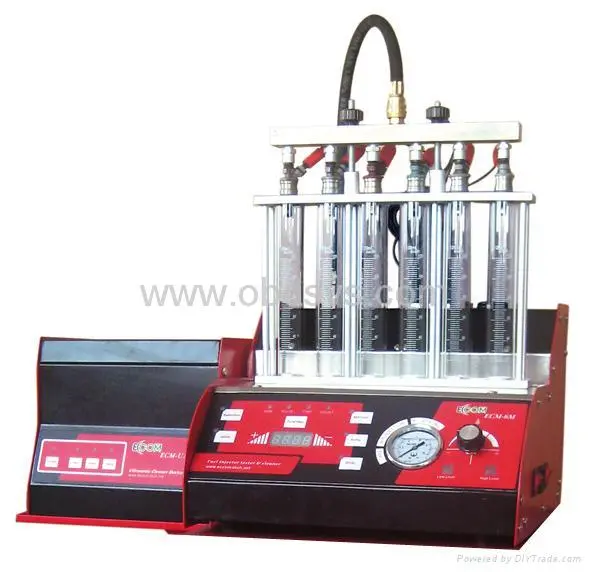

Yeah... you have a leak. Open the yellow pages and call around to part stores / machine shops to see who has a fuel injector flow machine.
Larger Napa stores that include a machine shop usually have these.
Pull your injectors and get them cleaned and flow tested. Replace the ones that are not repairable.
