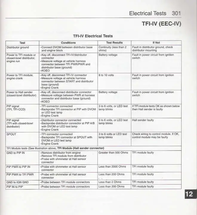

The TFI module mounted on the distributor is usually the culprit for a high speed miss on a warm engine. If the problem does not occur when the engine is cold, the TFI module is definitely suspect. You may need a special socket to remove the TFI module, but most auto parts stores will have one for $5-$7.
Be sure to use plenty of the heat sink grease on the new TFI and clean the old grease off the distributor.
See Automotive Tools Specialty | Auto Mechanic & Technician Diagnostic, Testing Equipment | Thexton
diagram courtesy of Tmoss & Stang&2Birds

I suspect it could be the TFI module. I have been down that road before when using an old unit off a parts car. But I had always remembered TFI modules as either working or not working. And this is a low speed/low RPM miss. The diagrams are awesome though, I will definitely run an Ohm meter on it when I get home and see what it says.
