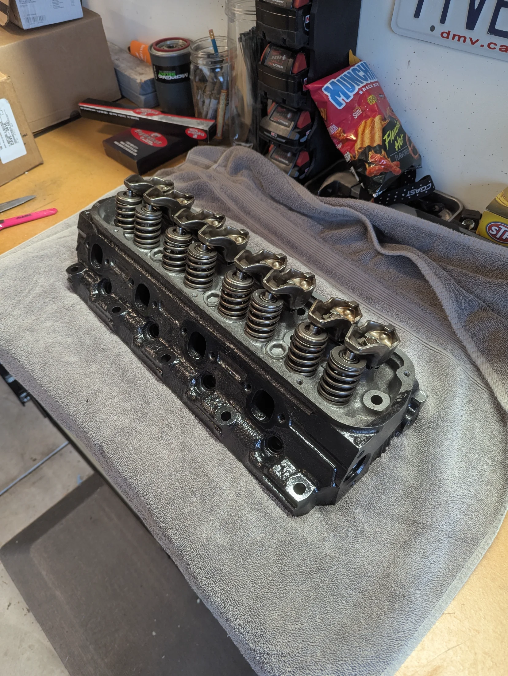

Gt40P heads, remanufactured. They came with new stock springs. And I have a B cam. Ive heard of people changing the valve springs on these heads but that's also $.
I had a really hard time getting the pushrod length right on the heads so there were many start ups and test drives with BAD valvetrain setup. I'm honestly not surprised something broke.
Do you know what springs were out on them? Just asking as if the springs do not have enough open or close pressure or get into a bind condition on max lift it’s no bueno.

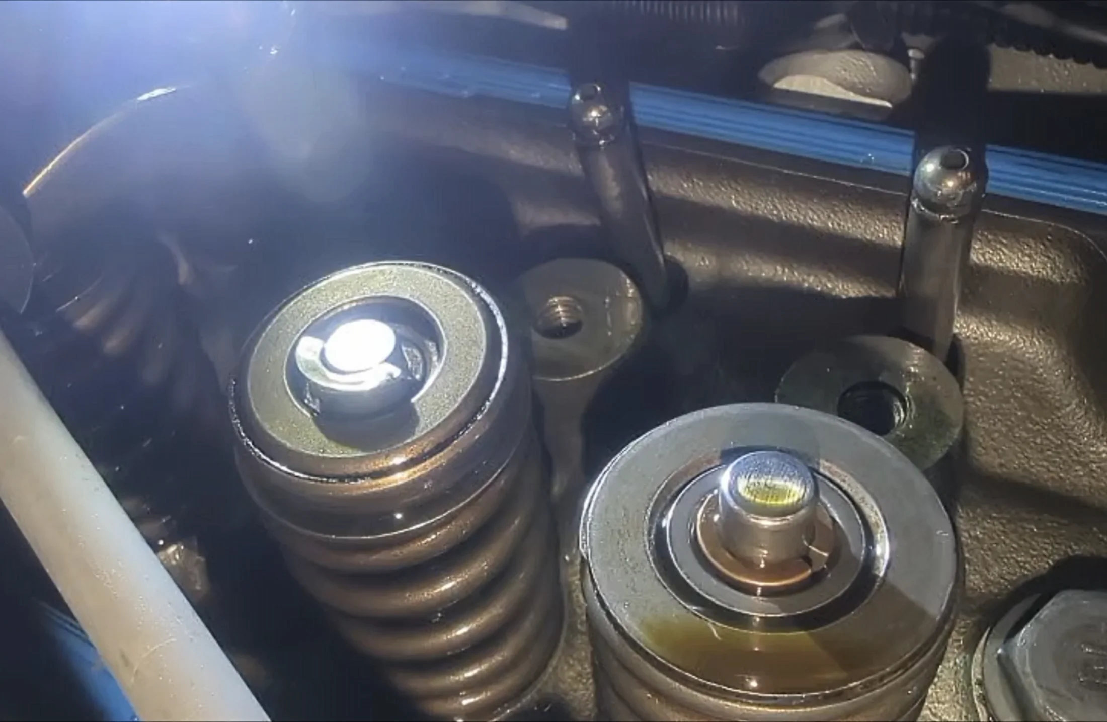

Not exactly sure what you're asking? The exhaust valve spring on cyl 6 is what has the broken lock. Here's a picture of the head. And the broken part
He's asking if you know whether the springs were matched to the cam.
What can happen is that a cam can provide more lift (more movement) than the spring will allow. This causes 'binding' and parts start to break.
If you're running an aftermarket cam, this can happen. Not so much on an OEM cam.
Gotcha, yeah the springs are just the stock ones. I looked back where I bought the heads, not even new springs. My cam is fairly mild. The previous owner told me there is a cam for sure but we don't know what it is. Guessing B cam.
My E7 heads ran the stock springs with this cam and didn't have issues. I know, new head = different geometry, but it's not like I have a block breaking setup... So maybe they springs are ok?
