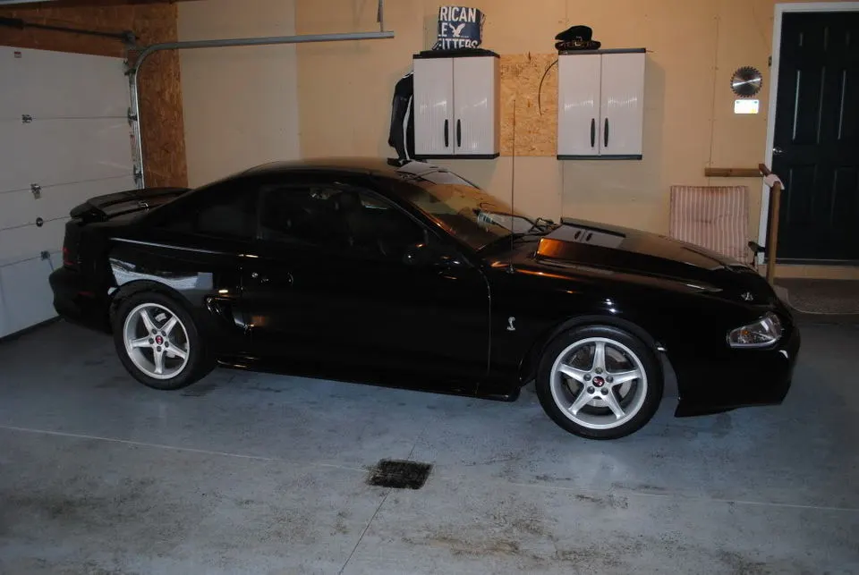

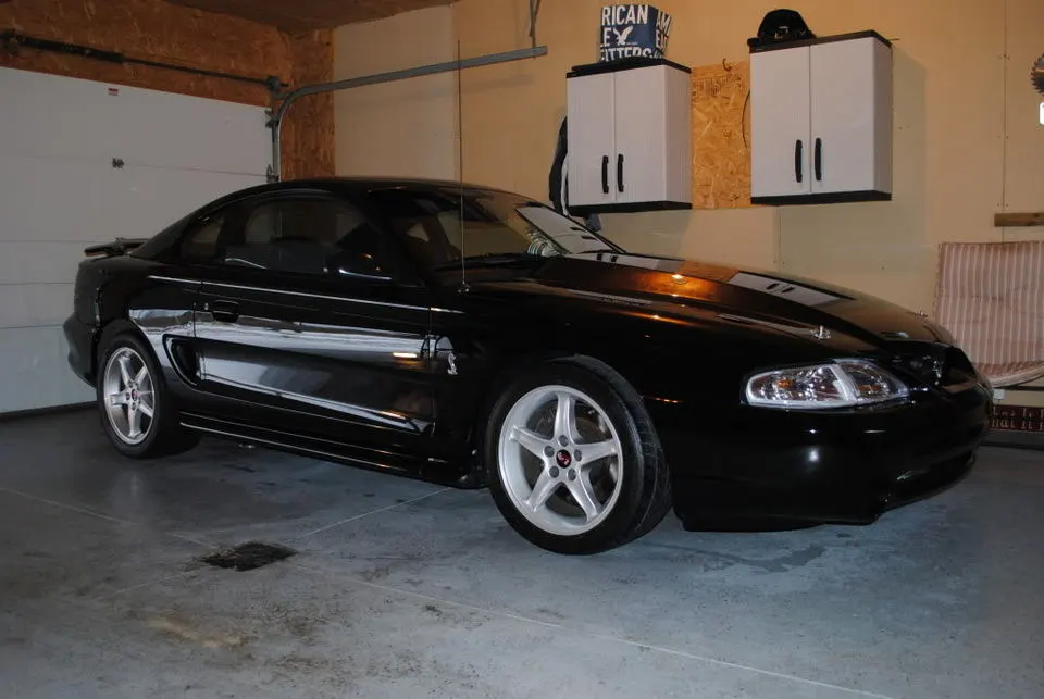

Oh OK, I didn't even think of that. Well, I used a sick day from work today and finally got the air bag installed in the right rear spring and gave it a coat of wax.
