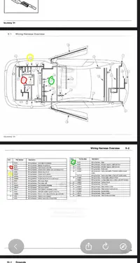

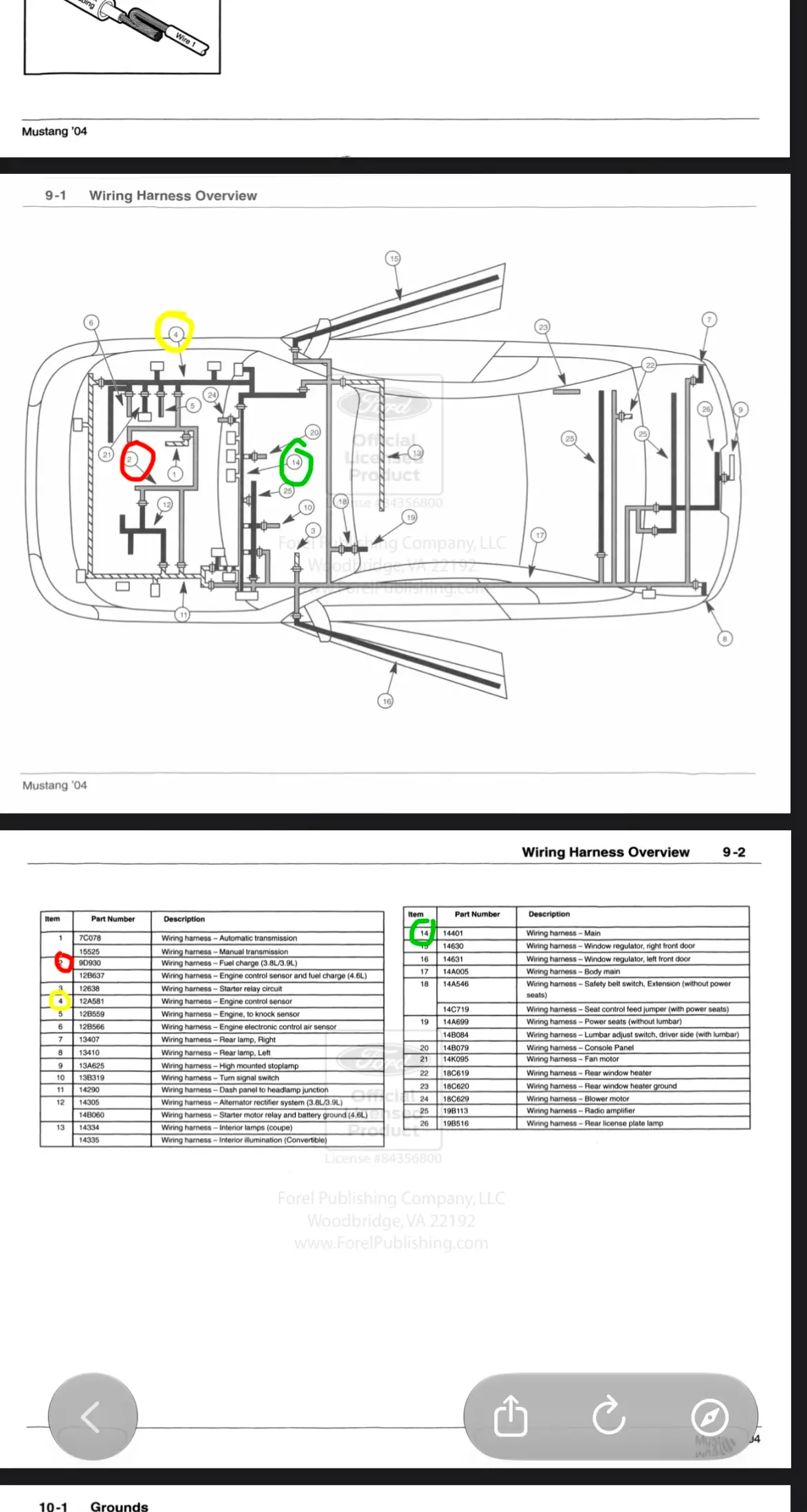

I’m in the same boat I have all 99 gt stuff the connector that goes do my dash (14401) is different can I just grab another year gt harness that matches my 04 dash harness and be okay? And just use my 99 engine harness (12b637) to connect to the possibly 02-04 engine sensor control harness (12a581)
