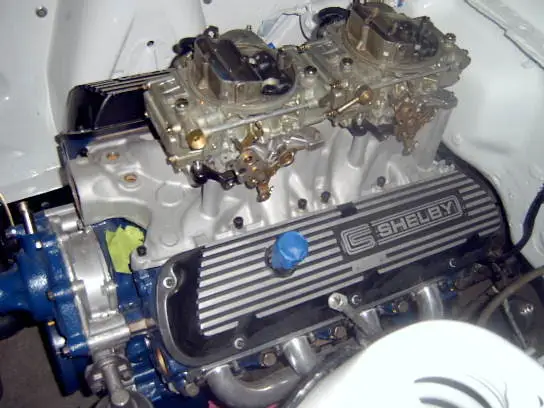

Well, then here's the basics: go to www.photobucket.com and register. Then click on one of the links that allow you to upload pictures from your computer to photobucket. Once you've gotten that far, then look under your picture and you'll see four rectangles, the bottom one is marked "IMG code". Simply left click on the box, and you'll see it say "copied", then right click, and select "copy", then when you post a response to one of your new freinds on Stangnet, simply put the cursor somewhere near the left side on a new line, right click again and select "paste" and it'll place your img address on that line, which will appear as your picture when you add the post. Like this:
