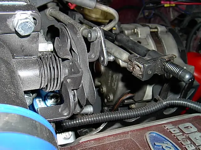

how do you do up the linkage??

Wasn't too hard really...
Just took a short piece of flat bar stock, cut it to the length I needed. You have to cut off the old throttle cable stud. Then I drilled holes in both ends of the steel bar and tapped them. The allen head bolt is a 6mm, and at the other end is a 5mm bolt that I ground the head of down to a ball and threaded it in. Works great.
