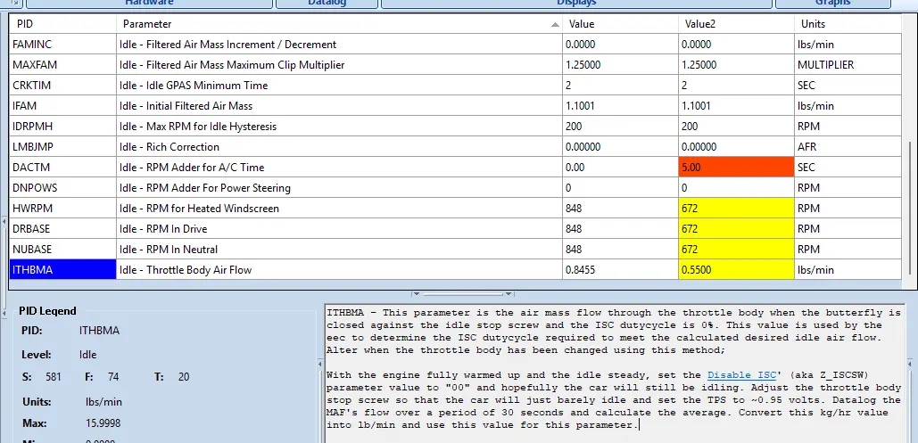

If you get a 65mm TB you may experience issues with idle quality etc as the stock tune is matched with the stock throttlebody and if you change the TB size it will throw the setting known as ITHBMA out of kilter and cause idle issues...

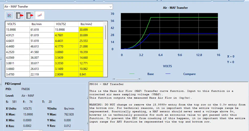

Im running a twin 61mm TB on my 351w and also running a 90mm MAF from a Lightning truck with an A9L ECU.
If you look at my tune settings below in order to get my engine to stop hunting with wild idle fluxuations from 450-900 when started for the first minute or two and have a high idle issue at times during the drive I had to do the steps outllined in the box and put the correct flow at idle so when I crank up my 351w engine it fires up clean and idles like a stock engine with zero idle hunting..
My tune settings are on the left and the stock tune is on the right so if youre considering upgrading the TB consider upgrading the MAF and getting a chip to make the appropriate changes to the tune so youre not on here screening the base idle reset and idle hunting posts on this forum looking for a miracle fix which are only temporary bandaids.

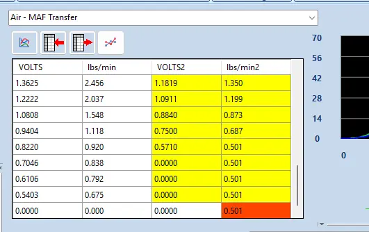

If you change the MAF to match the 65mm TB you must also change the flow numbers or the engine will run lean...This is a quick comparison between my 90mm MAF and the stock MAF
The Balancing Act And Why It Wont Jive completely when you change out the stock component/components..
When you mix up those two parameters, they fight for control over the idle engine speed:
  • The Lower ITHBMA Effect: A lower value tells the ECU that the throttle body is practically airtight. The computer panics thinking the engine will stall, so it aggressively opens the IAC valve to compensate. This forces a high, floating idle.
  • The Larger MAF Effect: Without your custom transfer function, a larger 65mm MAF to match the 65mm TB naturally reads a lower voltage for the same physical volume of air compared to a stock sensor. The ECU sees a tiny airflow number and scales back the fuel injector pulse width, making the mixture dangerously lean.

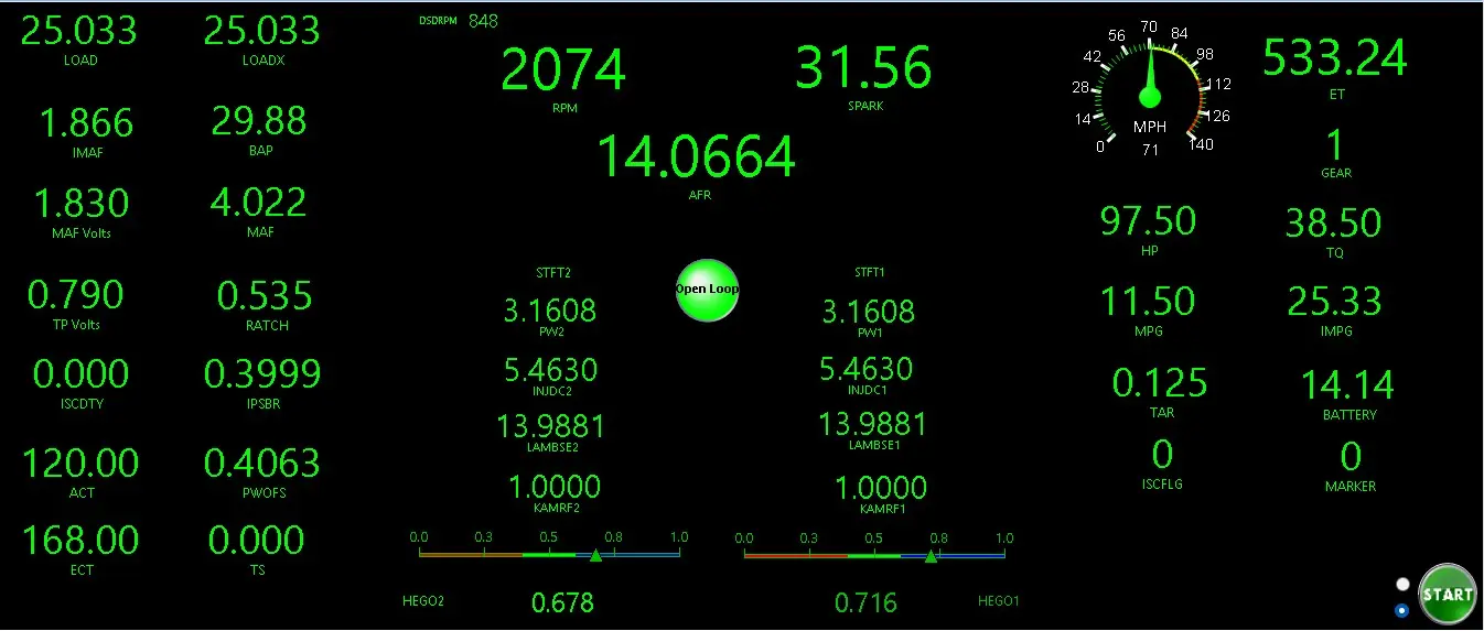

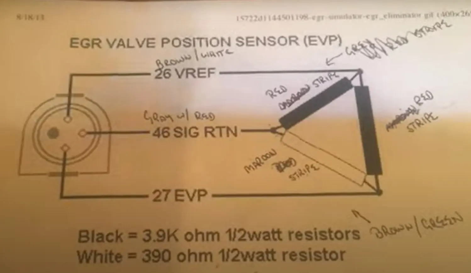

Having a wideband controller tapped into pin #27 of the ECU makes a world of difference especially if you haphazardly disconnected a bunch of emissions related devices without disabling them in the ecu settings or atleast making certain devices to make the ecu still work as intended with the removal of stuff like the EGR..
Where you see the 14.0664 setting is the feedback numbers of my AEM wideband controller and the LAMBSE settings are what my tune commands....
