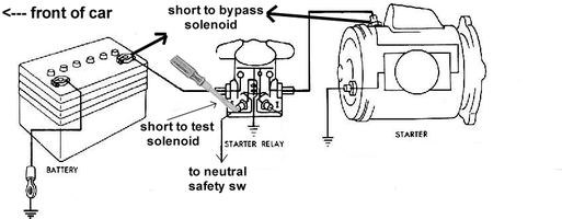

Jump the battery post on the solenoid to the front small post on the solenoid and see if that cranks the engine. If that works, then turn the key to run and see if it will start by the same method.
Could have a bad connection or bad ign. switch.
What you describe can be one of a few things. The first is the batt cable terminals. If that's ok then the solenoid for the stater. I have purchased brand new ones and the have failed out of the box. Then is the cable from the solenoid to the starter and last the starter it self. To discard the solenoid just take a jumper cable from the + of the batt to the solenoid post that has the cable going to the starter. Make sure the car is in park because this bypasses the neutral safety switch and will start in all gears.If it starts your solenoid is bad Also to test the solenoid take a jumper cable or screwdriver and make contact from the solenoid terminal that has the thick cable to the + plus side of the batt to the small terminal that's on solenoid towards the front of the car. If it starts the solenoid is ok and you may have a problem on the wiring that goes to the switch wich also is wired in series with the neutral safety switch.

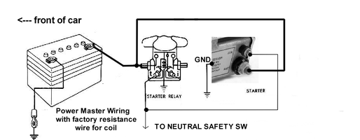

The neutral safety was probably eliminated. See if the car starts in all gears, if it does then it was eliminated at sometime. Below is the correct wiring for powermaster starters. This diagram assumes you are still using the original coil wire that has resistance on it. The factory solenoid it's just to apply full 12vdc to the coil when starting only. If you have the coil + terminal connected directly to a 12vdc switched source it will still work. In here the factory solenoid it's not used to start the car cuz the powermaster starter already has a solenoid built in.

Why is that?. There is absolutly nothing wrong with that diagram. The Power master starter has a solenoid built in to it, so using the factory solenoid to start the car it's doubling the application plus you’re adding a possible additional point of failure. I have seen many Ford replacement solenoids fail out of the box. The only reason to keep the factory solenoid in there is just to supply the coil with full 12vdc at start to bypass the resistance wire that drops the voltage to about 8vdc, there after the car switch takes over with that wire is supplying about 8vdc to the coil. So, if the car has a cable already with full 12vdc you can just eliminate the factory solenoid but remembering to use an electric terminal stud to connect the wires to the alternator and main going to the fuse box inside the car . Many people install this wire when replacing the factory coil with Pertronix and MSD units. I have installed 6 or 7 Power Master Starters to a few friends here exactly like this. All are working flawlessly up to today.

Simple, The Power master starter has a solenoid built in to it, so using the factory solenoid to start the car it's doubling the application plus you’re adding a possible additional point of failure. I have seen many Ford replacement solenoids fail out of the box. The only reason to keep the factory solenoid in there is just to supply the coil with full 12vdc at start to bypass the resistance wire that drops the voltage to about 8vdc, there after the car switch takes over with that wire is supplying about 8vdc to the coil. So, if the car has a cable already with full 12vdc you can just eliminate the factory solenoid but remembering to use an electric terminal stud to connect the wires to the alternator and main going to the fuse box inside the car . Many people install this wire when replacing the factory coil with Pertronix and MSD units. I have installed 6 or 7 Power Master Starters to a few friends here.
