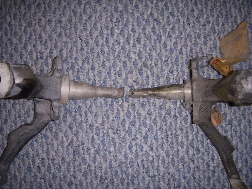

The outer tie rod has a smaller stud through the spindle than the V8 does so V8 tie rod ends will not work on the 4 lug spindle ,if i remember correctly the spindle threaded end is also smaller than the v8,i have a set of v8 and 6 cylinder spindles here some where but i am pretty sure they are different. The pitman on the steering box has to be changed as well ,the 6 cylinder has two holes and the v8 only has one ,the holes are bigger on the v8 and they are both shapped different. If you want to use the v8 power steering you will need the power pitman arm as it is different fron standard steering

67 -69 spindles are the same for drum 6 cylinder and V8 so those spindles do not have to be changed out ,but 65-66 spindlesare different

May be a bit hard to tell the difference in this pic but you can see the size difference in the threaded end of the 6 cylinder,on the right, and v8 spindle on the leftThe tie rod ends are a little easier to see the size difference

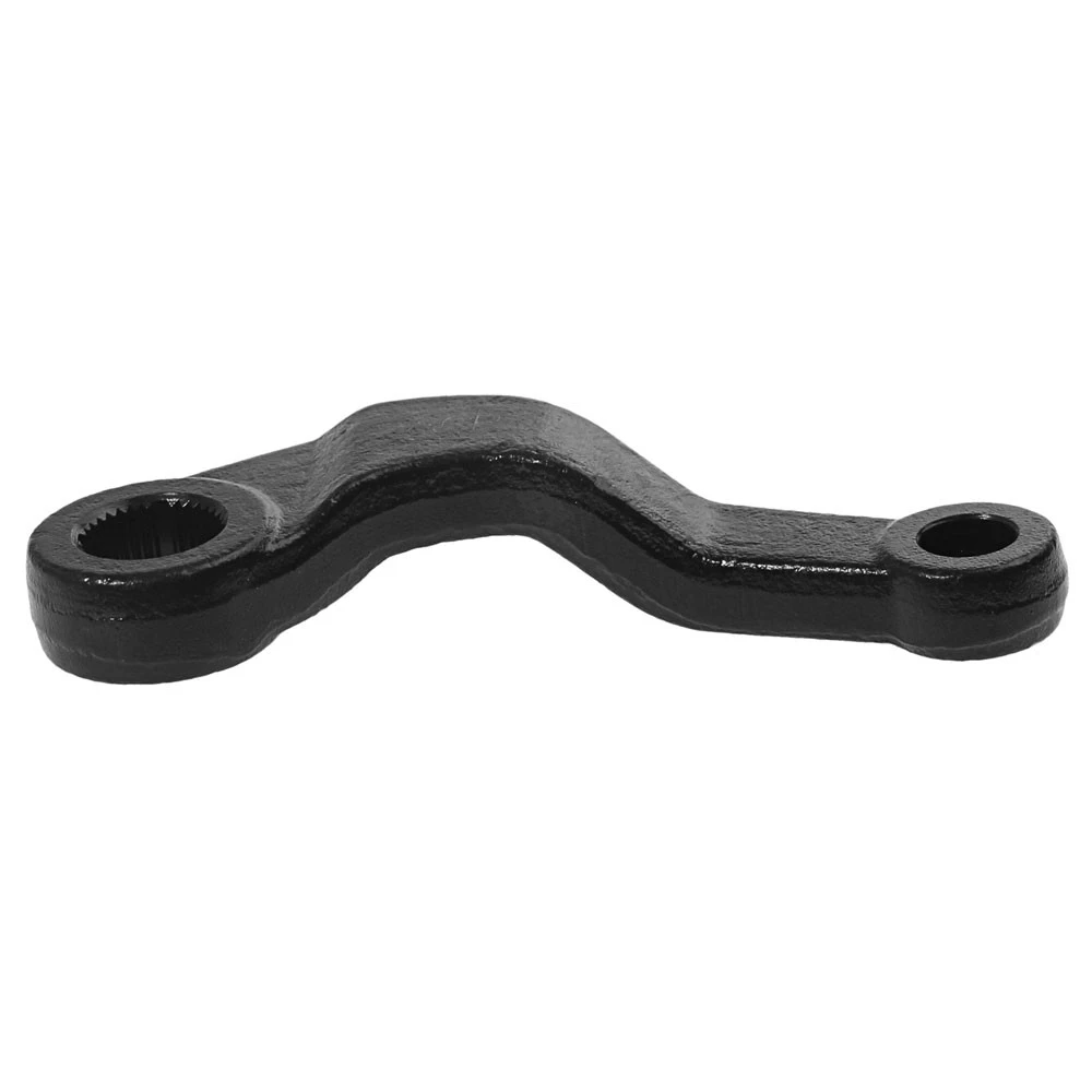

Power steering pitman arm
Standard steering pitman arm
6 cylinder pitman arm

Wow, definitely different! I need to look at the pitman from my parts car, I'm thinking it looks like the standard one, but not sure. I know the six cylinder pitman is totally different.

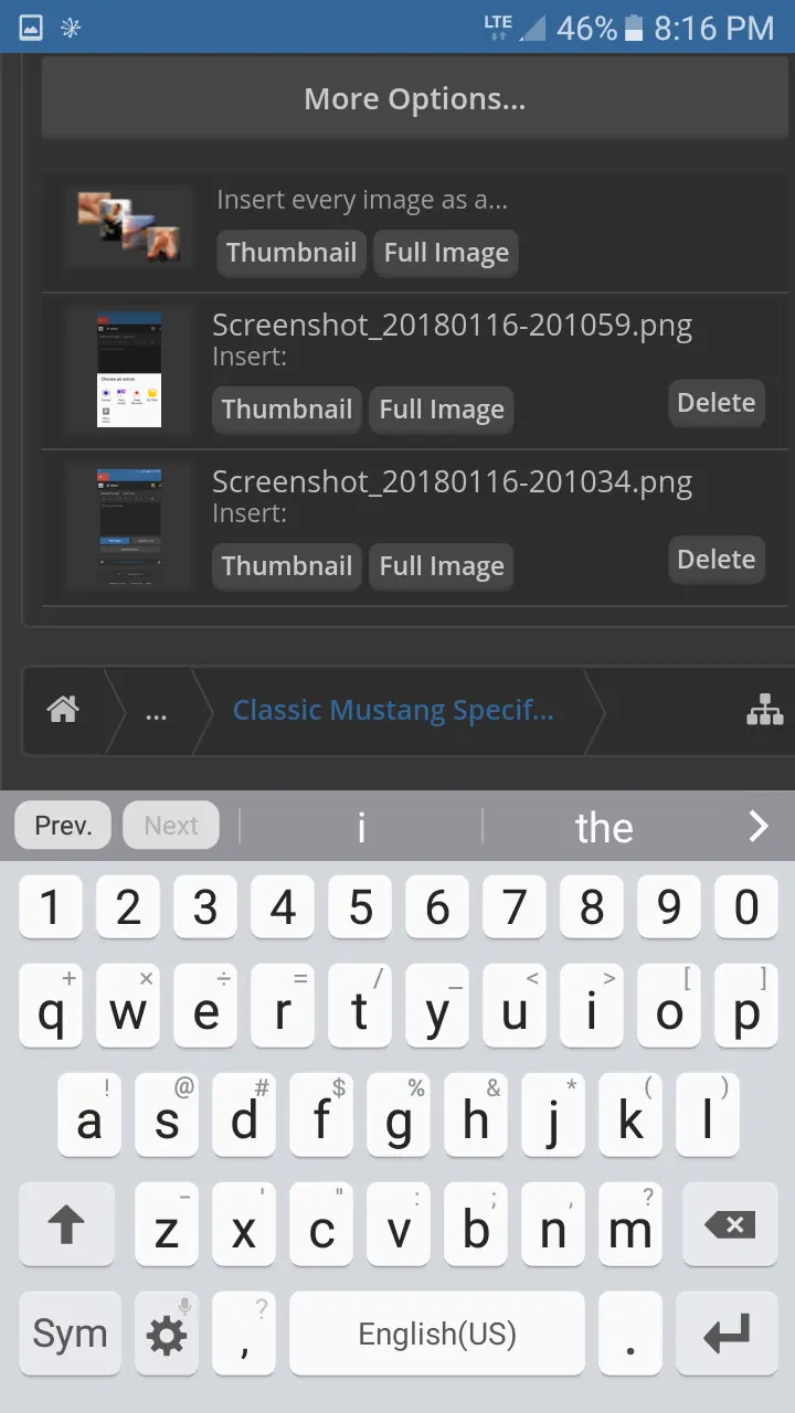

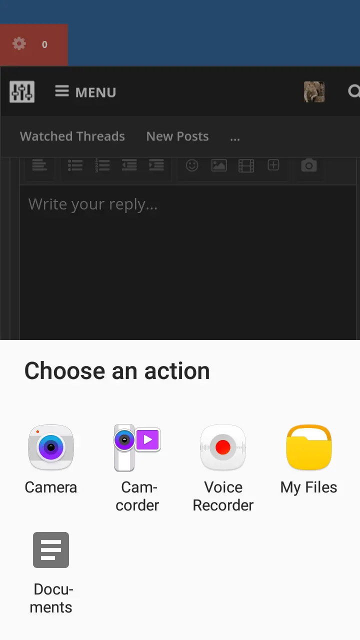

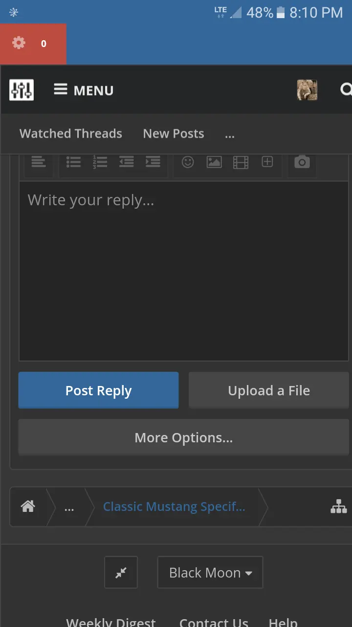

You can load images directly from your cell or computer . You may have to save them into your album if you have a cell
horse sence
12,411
8,352
233
Wile Coyote's stunt double
Jan 16, 2018
#14
  • Jan 16, 2018
  • #14
At the bottom of the text window you will see upload a file ,click on that ,a window will pop up for you to chose where you want to get the image from off your device ,it will be my files or documents . Click on the one you want and your saved images will open ,choose the one or ones you want and click on it ,a window will open asking if you want thumb nail or full image ,click full image beside the single pic or insert every image as full image and wait for the pic or pics to load ,then click post reply

Jim, I'm gonna have to digest that a bit, I'm sure it's not that difficult, but for someone like me, I'll make it more difficult then it needs to be.
C
Caveman49
Jan 12, 2018
27
Alabama
Jan 16, 2018
#16
  • Jan 16, 2018
  • #16
Hunh, it worked, cool.

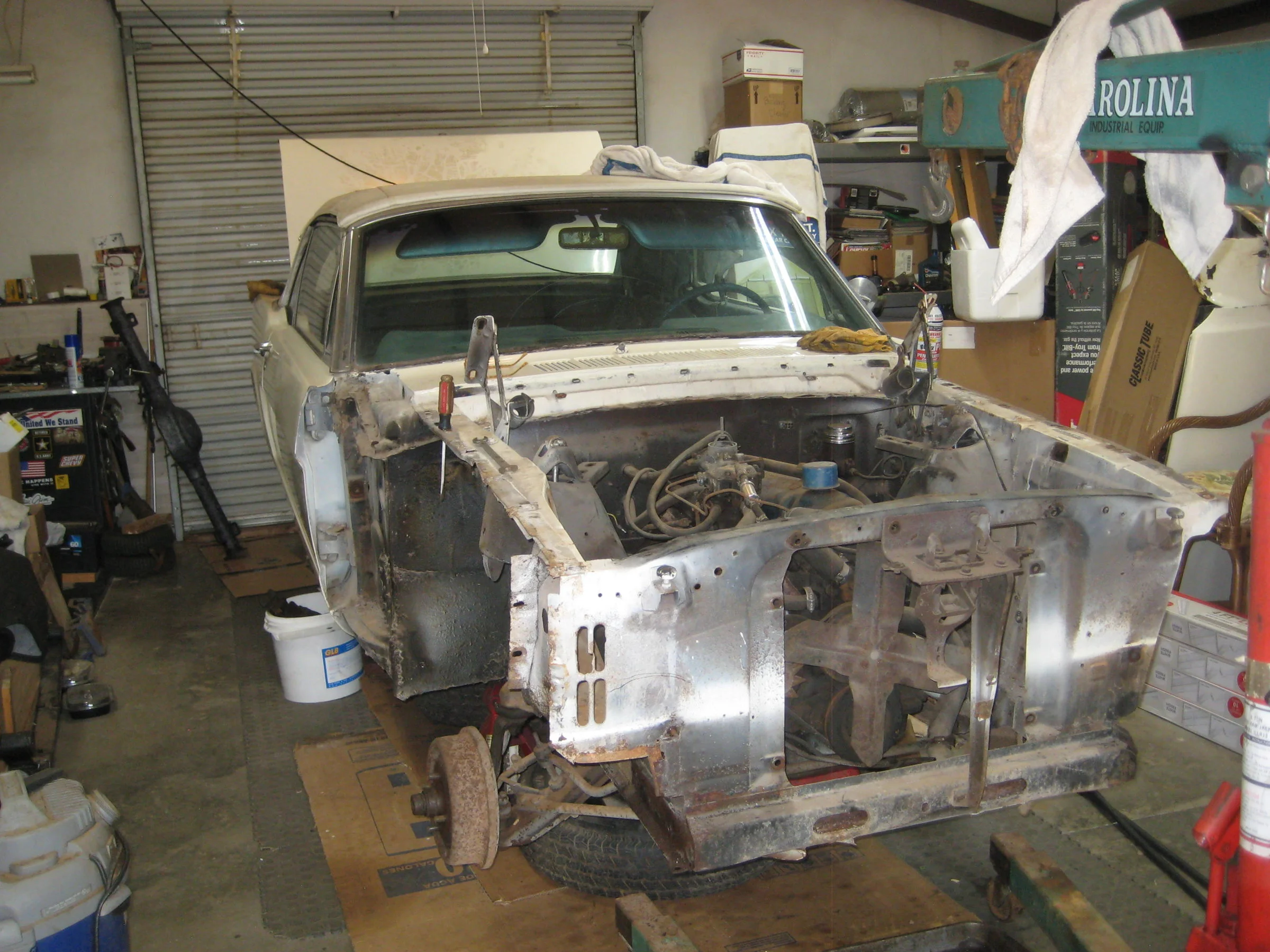

Where the convertible is at today.
