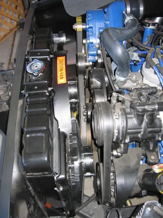

Here's what it looks like with the engine slid back 5/8", and a 3" thick radiator.
If you aren't concerned with a "stock" appearance, you can slide the radiator forward a bit by cutting out the radiator support.
The supercharger and A/C will require a much better/larger radiator than the stock 19" wide radiator. I have a 24" radiator for a '68 big block car in here.
I'd also recommend using an air dam under the front cross member, to increase the vacuum under the engine compartment. This will help evacuate the hot air from the engine compartment.
