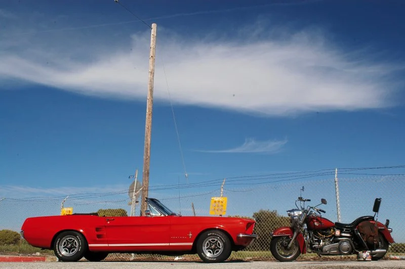

Hi all,
Looking for feedback on set-ups for a 67 Convertible.
Just another bone stock V8 4bbl air cond car with power steering.
Dont need race equipment but do want some performance upgrades for this old girl, I need a complete suspension from the frame out.
Full brake system will follow.
Been reading the forums for a few days, what I came up with was
New flaming river steering box 16:1
A few braces top & bottom to stiffen up the front end (I'll make those)
Was looking at the camber correction kits
The urethene bushings for the suspension with grafite in them, except for the rear strut rod bushing, I'll keep stock for the bump damphing.
I see an improved idler arm by moog.
I also see many stores have "suspension kits" Are they worth the money or is it better to go peice by peice? After all I need everything, arms, springs, shocks.
Again I am looking for a street suspension not a track car
Any suggestions are greatly appreciated.
Tim:D
