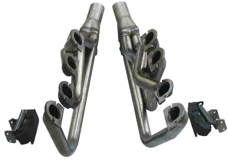

Such mounts are available, for the purpose of this swap. So are conversion headers.
