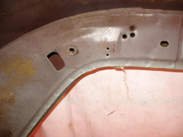

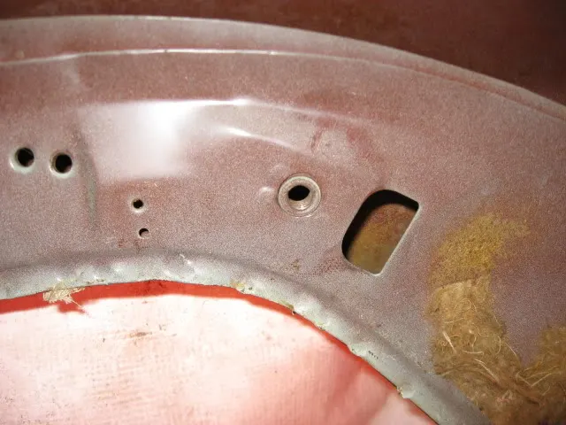

I think the hole (opening) was there in '67 but they didn't weld a nut in until late '67/early '68? it varies by plant I'm sure. I can take a better pic tomorrow but here's one of a '68
I can put a ruler next to it so you can guess placement better, I have since removed the belt so you'll be able to see the threads. I think that you may be able to pull the windlace loose, peel the headliner loose as it gets flapped over and the windlace clips it in place. You may be able to pull enough loose to get your hand in there to figure out if you have a nut welded in and where you need to make the hole to attach the upper belt. You have some fudge room for making the hole as the cover for the belt and the bracket are larger than the hole.

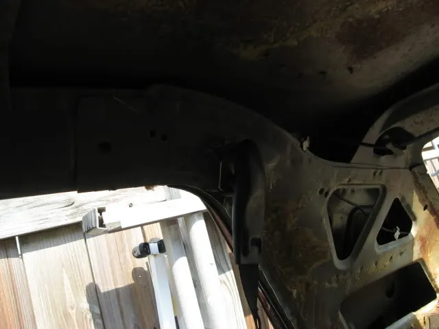

Your pictures made me check again, JonK. I only checked the drivers side yesterday and mine has a hole but no threads. On the passengers side, there are threads but they aren't welded in inserts like yours. It looks to be a U-nut, similar to those used to secure the front fenders, that slips in through the opening behind the hole. There may be hope for us afterall.
I don't know if I'd trust a U-nut or J-nut to mount the seatbelts. I'd trust something more like a heavy (grade 8?) nut welded to a plate first, like this one:
It may need to be trimmed down to fit through that larger hole on the rear side and worked into the space where the nut would show through the hole.
