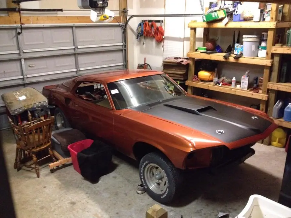

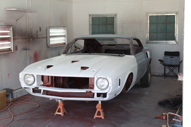

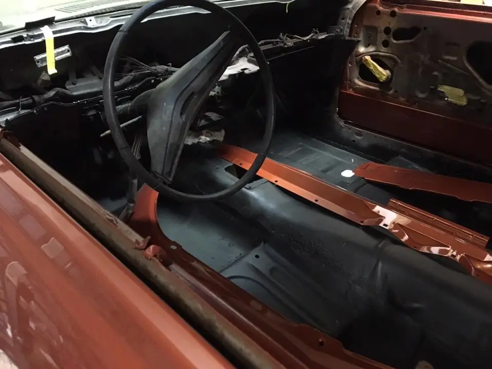

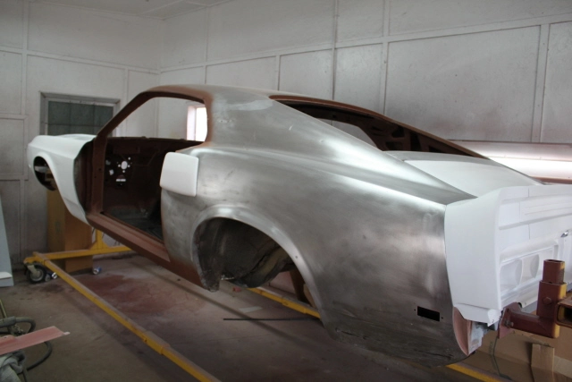

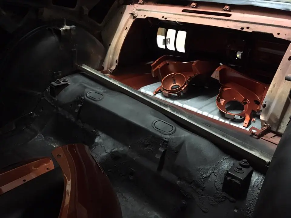

First time post here folks! I have a 69 Fastback that's back from paint and body and is like new. I believe...I hope I have all the parts to put her back together. I'm from NY and now in NC, so the car was rusted like crazy, so that's why near new.
So the question...
Where do you start for step 1 for assembling your Stang?
Windshield and back glass in. There's a good amount of wiring in the car, but unsure what's good, what's not and what's missing.
I don't know if I'm doing the photo think correctly, but tried. Let me know.

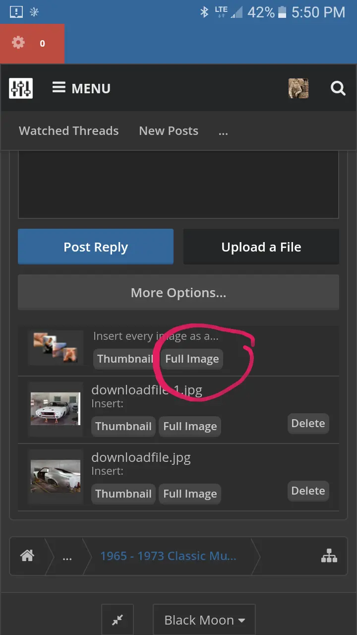

Welcome ,mr. Jones ..mr.Jones..mr .Jones ..mr .Jones...you got a good thang going on.

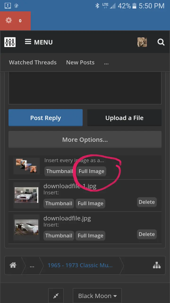

To load your pics ,click upload file down below ,that will open your albums on your device.Choose the pic you want and click it ,it will load ,click full image and it wiil place the image in the post window ,click post reply and your post with image will appear
Good ,if you click , full image ,as i have circled below ,after you load your pics ,they will be full size on the screen when you hit post reply

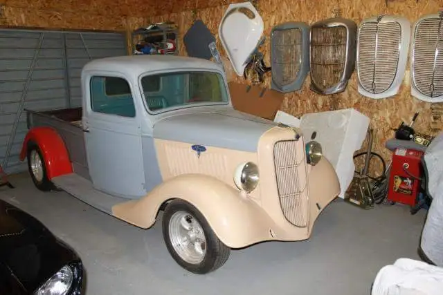

Nice ,headliner first ,then carpet ,all wiring shuold be in now ,followed by the rear trim panels ,trap door if fold down seat . Do the heater box before the carpet actually it will go in a lot easier. Back seat next . Finish up dash ,then front seats,i do the front seats last because if you need to get under the dash it is easier with the front seats out.
And i see you like the old Fords ,so do I
Thank you for the info! That's an old beauty!!!!
