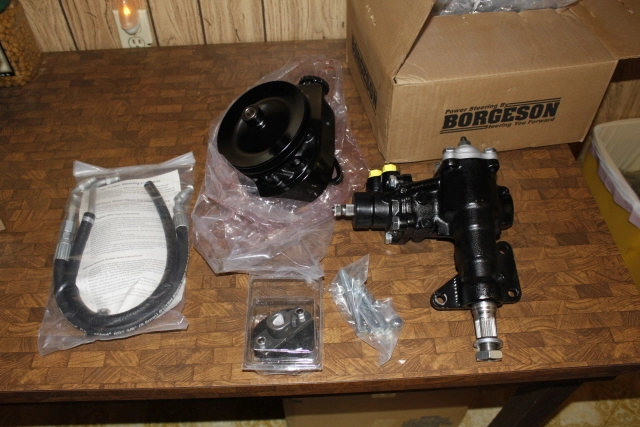

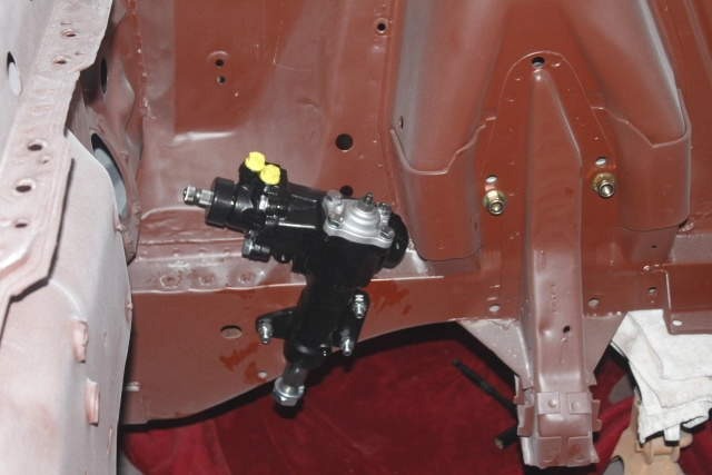

I haven't driven my 69 ,but i put the Borgeson steering unit in it .Just turning the wheel i can tell a difference ,All the slop is gone .It is a very simple bolt in and comes with everything you need to install.
I have driven a car with a rack and pinion and really didn't care for it ,it was a bit darty for me /to sensitive, and tend to walk at the slightest touch of the wheel .
It is the valve assembly that usually causes the loose feeling in the stock steering ,when that is gone the steering will feel tight again.
