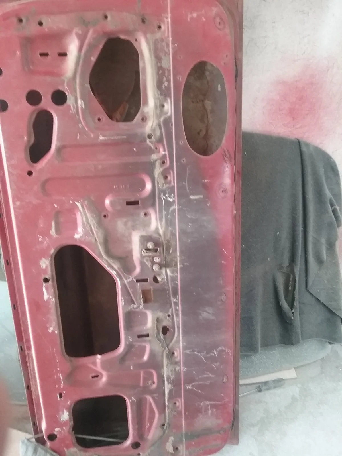

This is a deluxe 69 door ,had deluxe panels, you can see the screw holes i have circled ,71-73 is pretty much the same thing
If it didnt have deluxe panels there will be no screw holes ,the screws went through the carpet at the bottom ov the panel and drilled directly into the door shell
Were the screw heads visible from inside then?

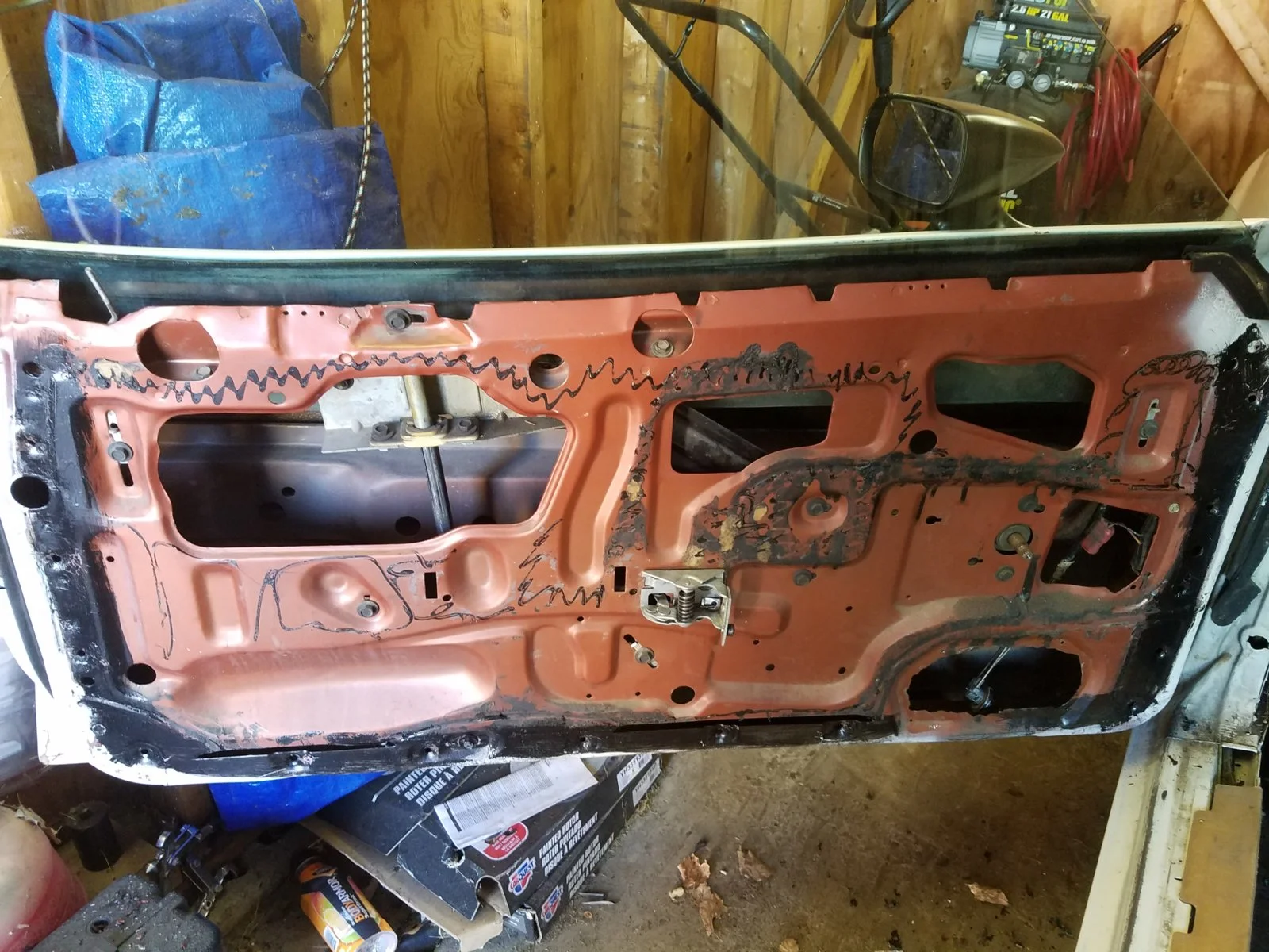

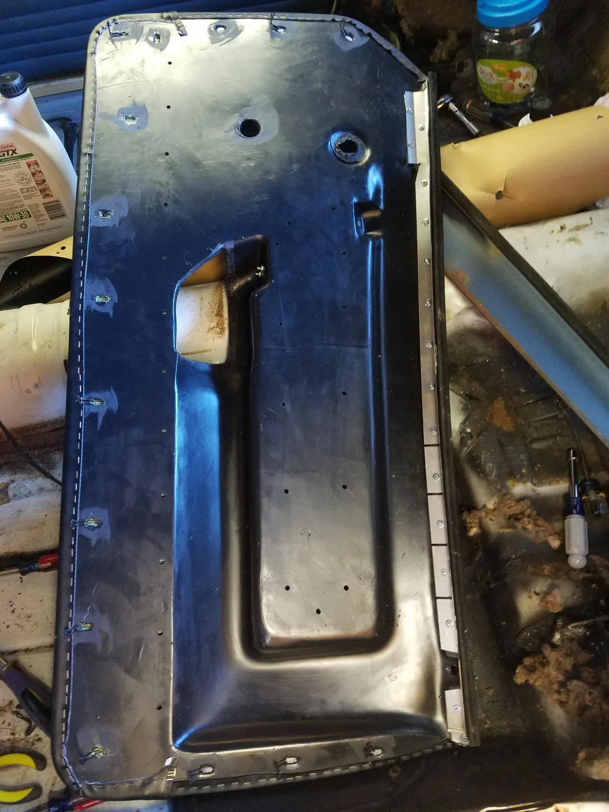

I have attached pictures of the back of the door panel and the door itself. While taking the picture I realized that the curvature of the door panel is hitting the door and forcing the panel to not sit flat. That doesn't seem normal unless the doors are different for deluxe and standard interiors.
