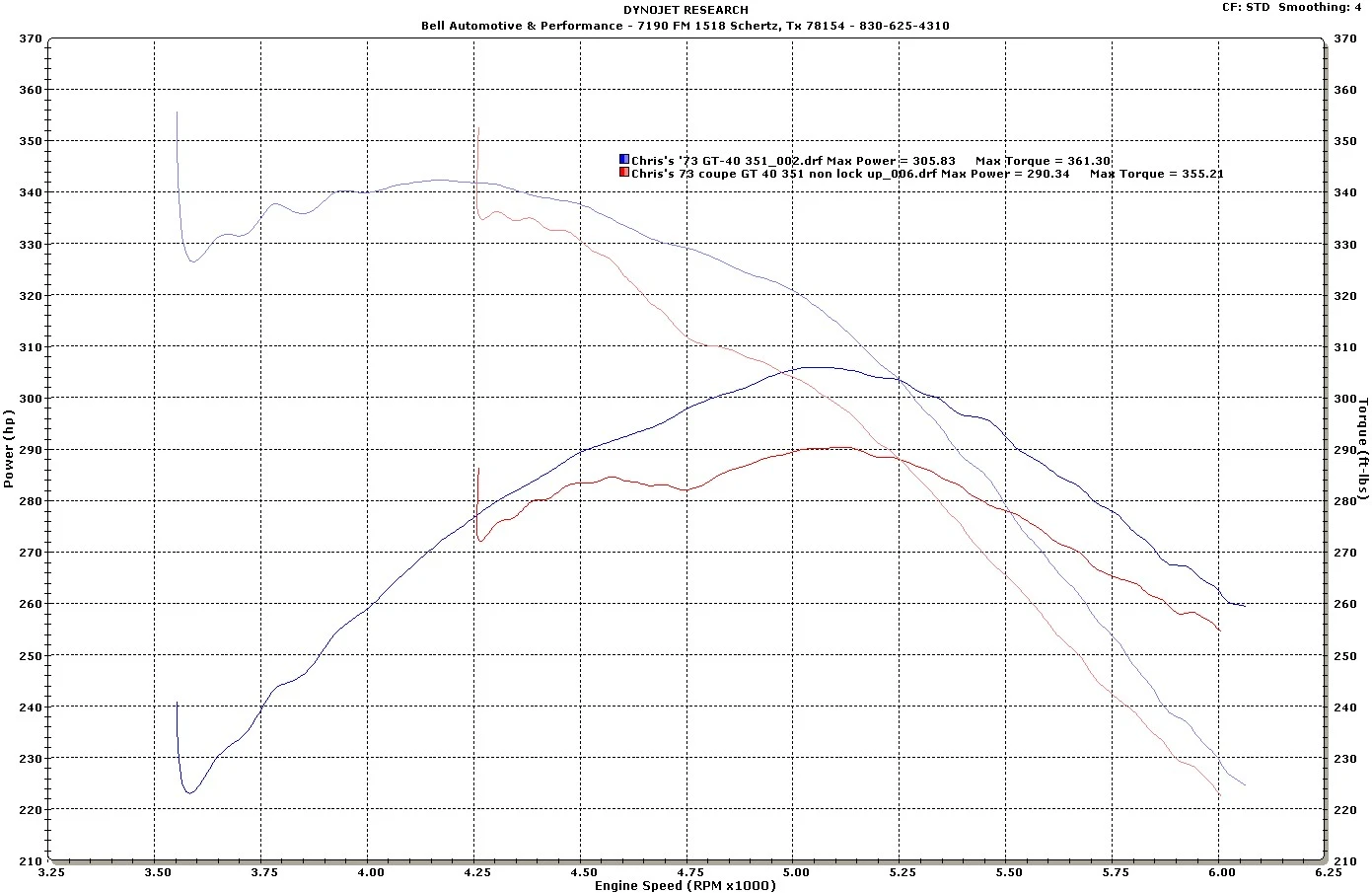

This lockup AOD setup put down 305HP to the wheels and 360lbs o TQ. Red lines in the graph
After the breakdown i was convinced to go non-lockup and procured a used edge racing converter, lentech valvebody, and all the other nonlockup goodies. according to my Mechanic this AOD should hold up to 600hp, buuuut as the graph shows i suffered in power to the wheels. I sent the converter to edge racing who retooled it to 3500 stall speed, per my mechanic. This setup made 290/355 and the power band look way different.
