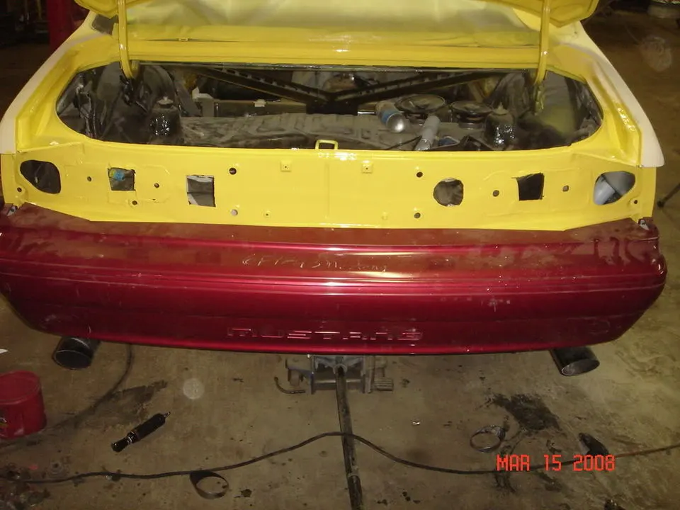

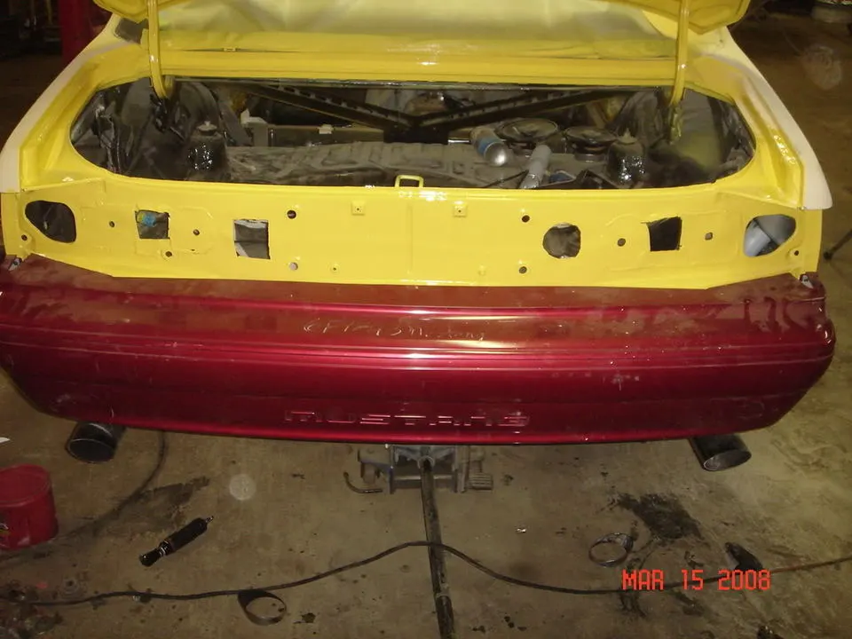

Me!! Project 81 Hack Job. I put 87-93 LX lights in this car. The bulb configuration is totally different. You cannot bolt them in nor will the sockets fit through to twist in the tails.
I have a before pic on my pc at home. I'll edit and post it tonight around 9:00-9:30pm.

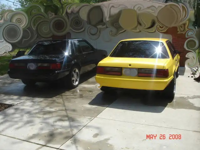

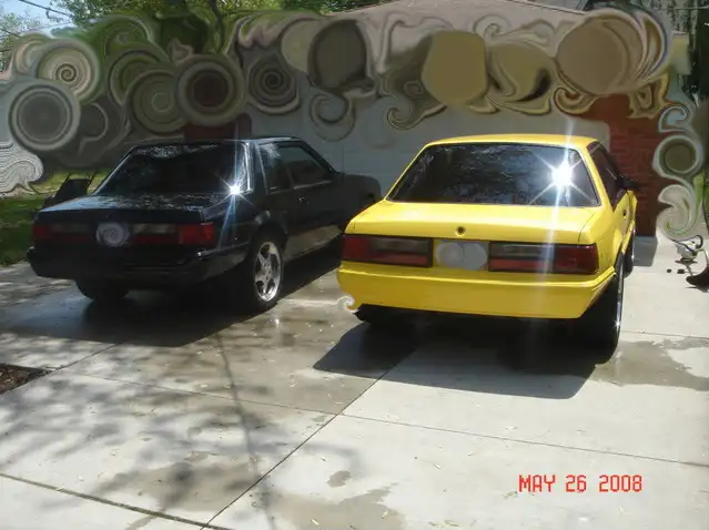

AFTER: I didn't spend tons of time making it look all pretty because it's covered up, but I did make sure there were no leaks after and they was not.I had to weld a bunch of metal to make the new ones work, so you...would have to cut out metal from a 83-93 tail panel to get the 79-82 lights to fit. It was a lot of work. It's not worth it on your car if it's a complete running car. On a project car, well...everything is a ton of work, so to me it did not matter.
AFTER AFTER!!

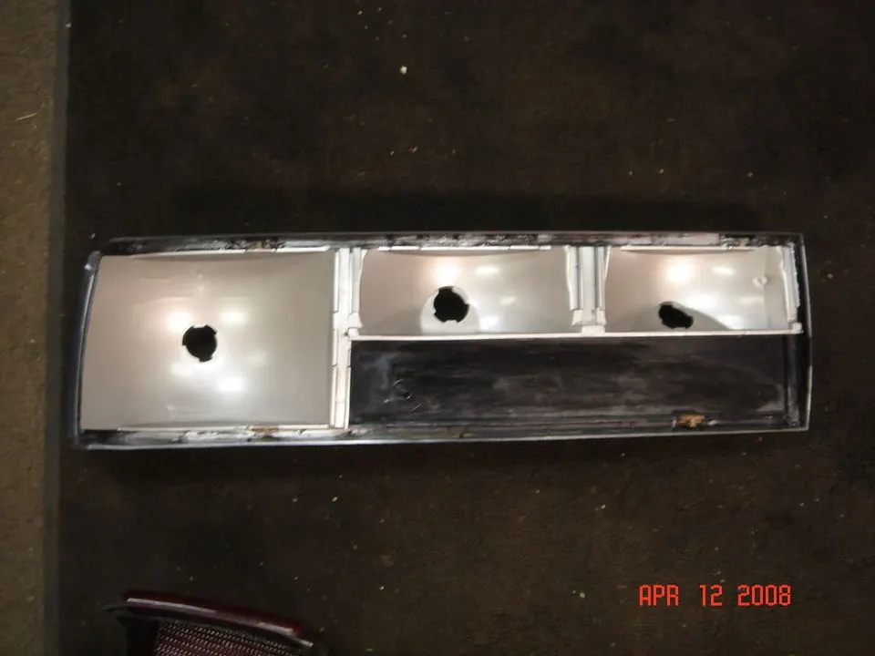

Good point. They are not bright at all. They take the old school twist in bulbs which suck.

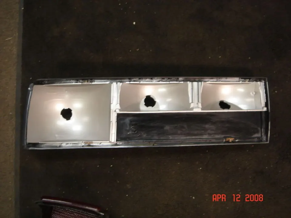

One thing you can do to make them bright though, is to take the lens off the backing and paint the backing a nice bright silver. Many of the fox tails develop molding, or the factory silver backing peels off because of age. I painted the backing of Hack Job silver and maaaan those lights were bright.

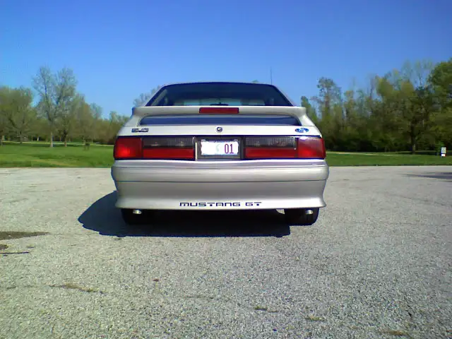

Back when I had my LX tails I gave the stoplights a fresh coat of silver, then I painted the backup/turn signal part black and it gave it a nice smoked look. But now I have Cobras so I painted the whole housing silver.
Wow!!! :nice: Nice job man. That does look sick! I never thought of doing that. It is totally noticeable. :nice:
