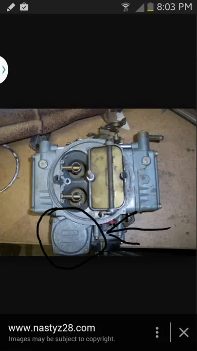

Hammering Fox New Member Feb 1, 2015 1 0 1 Feb 1, 2015 #1 Feb 1, 2015 #1 I have an 85 mustang gt stock carb for some reason 4bbl will not open any suggestions will be helpful.

Boosted92LX It's only an inch or two. What's the big deal? 15 Year Member Dec 19, 2010 5,721 4,244 224 Feb 1, 2015 #2 Feb 1, 2015 #2 Hammering Fox said: I have an 85 mustang gt stock carb for some reason 4bbl will not open any suggestions will be helpful. Click to expand... Open up the vacuum diaphragm housing on the side of the carb and inspect the rubber diaphragm. Probably broken.

Boosted92LX It's only an inch or two. What's the big deal? 15 Year Member Dec 19, 2010 5,721 4,244 224 Feb 1, 2015 #3 Feb 1, 2015 #3 Right there. Reactions: A5literMan
