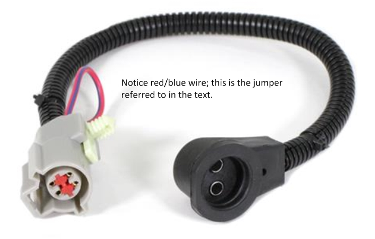

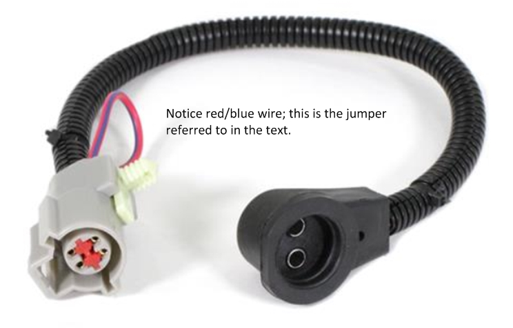

The next check is courtesy of Killing Hours.
For manual shift transmissions only: check to see that the backup light switch harness is intact and in good condition. There is a wire in the harness that loops 2 pins coming from the body side of the harness. This is the bypass for the auto transmission Neutral Safety Switch. If the connector is damaged, oil soaked or missing you will have a no crank condition.
Backup lights harness for 5 Speed transmission showing the bypass loop for the Auto Trans NSS
Courtesy of Killing Hours
