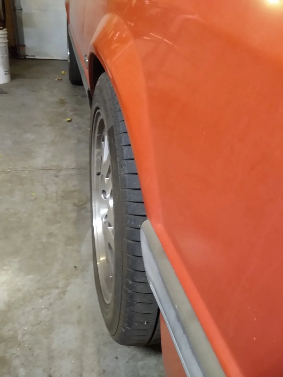

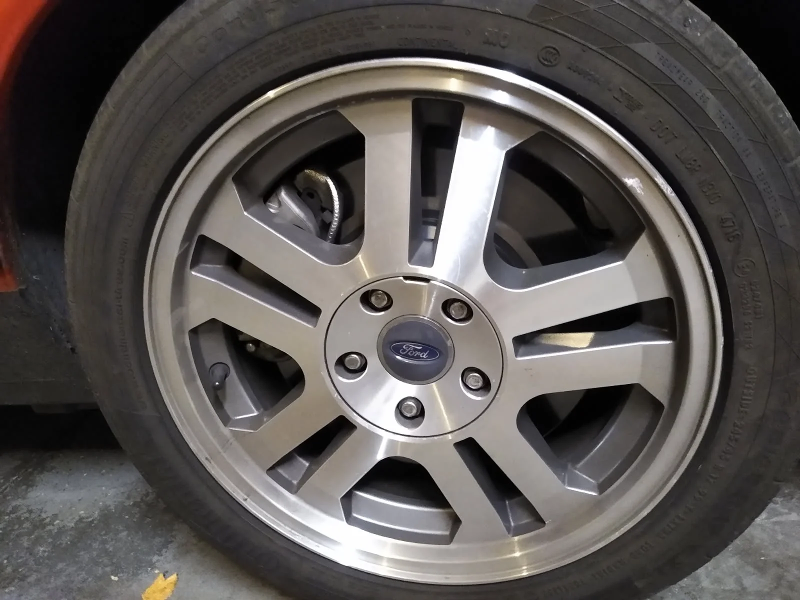

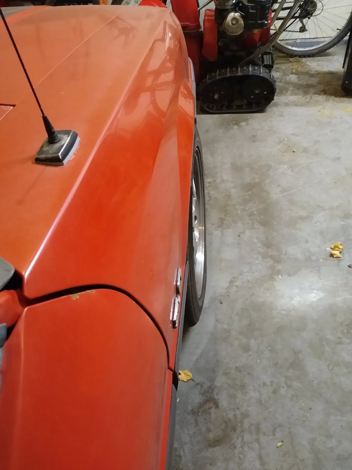

Personally I'd swap over everything off the front of the 95' except the K-Member. Rack, LCA's, etc. The longer SN95 arms work great with the 86 K Member.
Here's a couple pics of my setup utilizing 05-06GT (45mm offset) wheels and 04 GT LCA's. Zero rubbing, zero trimming, can turn full lock to lock with stock SN95 rack limiters and 245/45-17's. Wheels also clear the SN95 Cobra brakes. Running -.7 degree of camber, 3.5-3.8 Caster.
