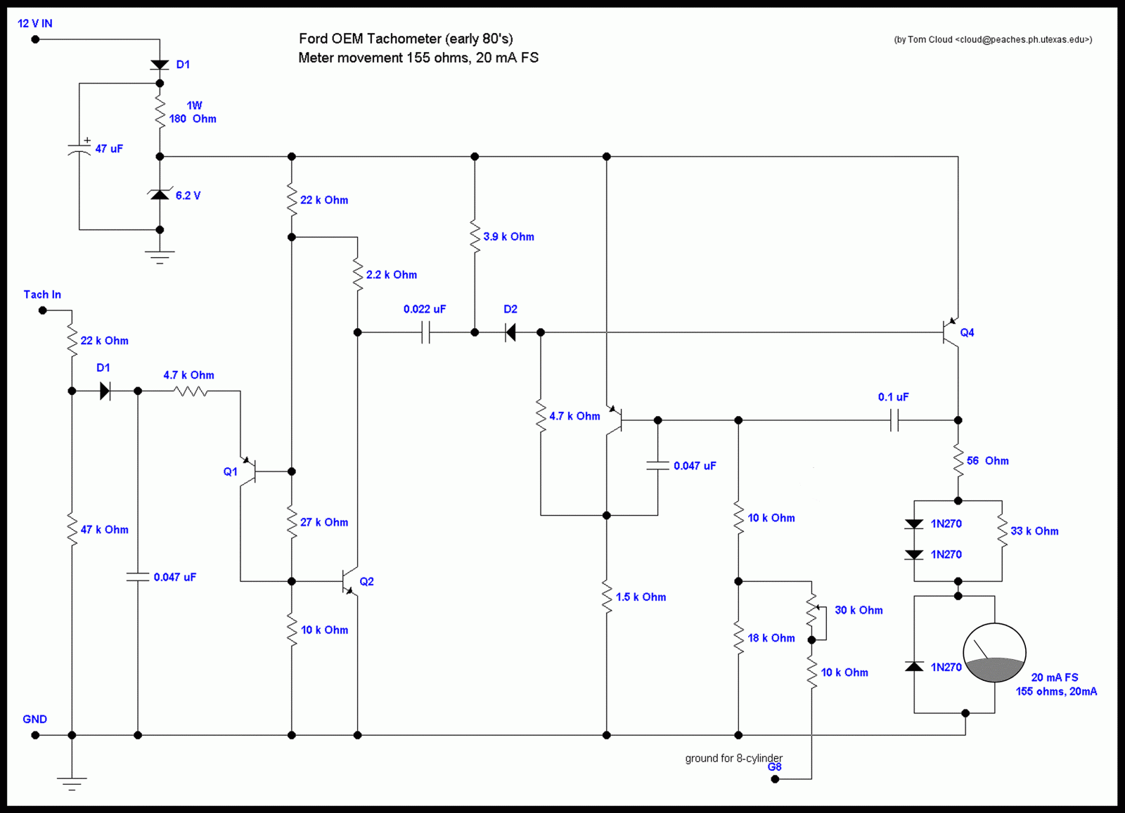

M marshall101 New Member Jul 29, 2018 4 0 1 Orlando May 25, 2019 #1 May 25, 2019 #1 85 Gt tachometer keeps blowing the fuse.
jrichker StangNet's favorite TOOL In Remembrance. Thank you for your contributions Mar 10, 2000 27,512 2,813 234 Dublin GA May 25, 2019 #2 May 25, 2019 #2 marshall101 said: 85 Gt tachometer keeps blowing the fuse. Click to expand... Look for failed components in 12 volt input such as D1 diode, 180Ω resistor, Zener Diode 6.2 volt or the 47 uf capacitor. Attachments Ford-tach-300.gif 89.6 KB · Views: 352
