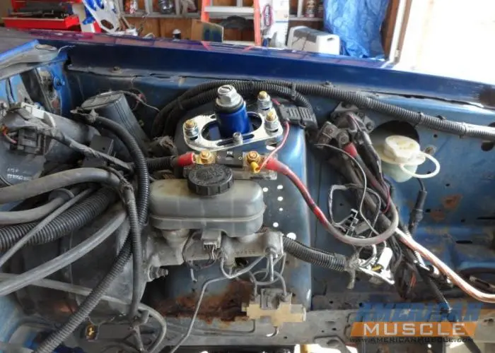

Can you post up some pics? I was at the BBK web site looking and it looks like it should go in this order (using a factory style strut): Strut, strut spacer, bushing sleeve, small washer, lower bushing, strut mount, upper bushing, aluminum plate, larger flat washer, nut. I know sometimes on CC plates, if things are not put in the right order they can throw things way off as far as how the strut sits in there. I made that mistake on the first UPR CC plates I ever did.
You have to mess around to get the poper spacer sequence when using lowered springs. The instructions should tell you which ones to use and what order. I've never used that brand, but CC plate install is pretty much the same for all models . Did you make sure you have them on the proper side and oriented the right side up.
Does it look like this?

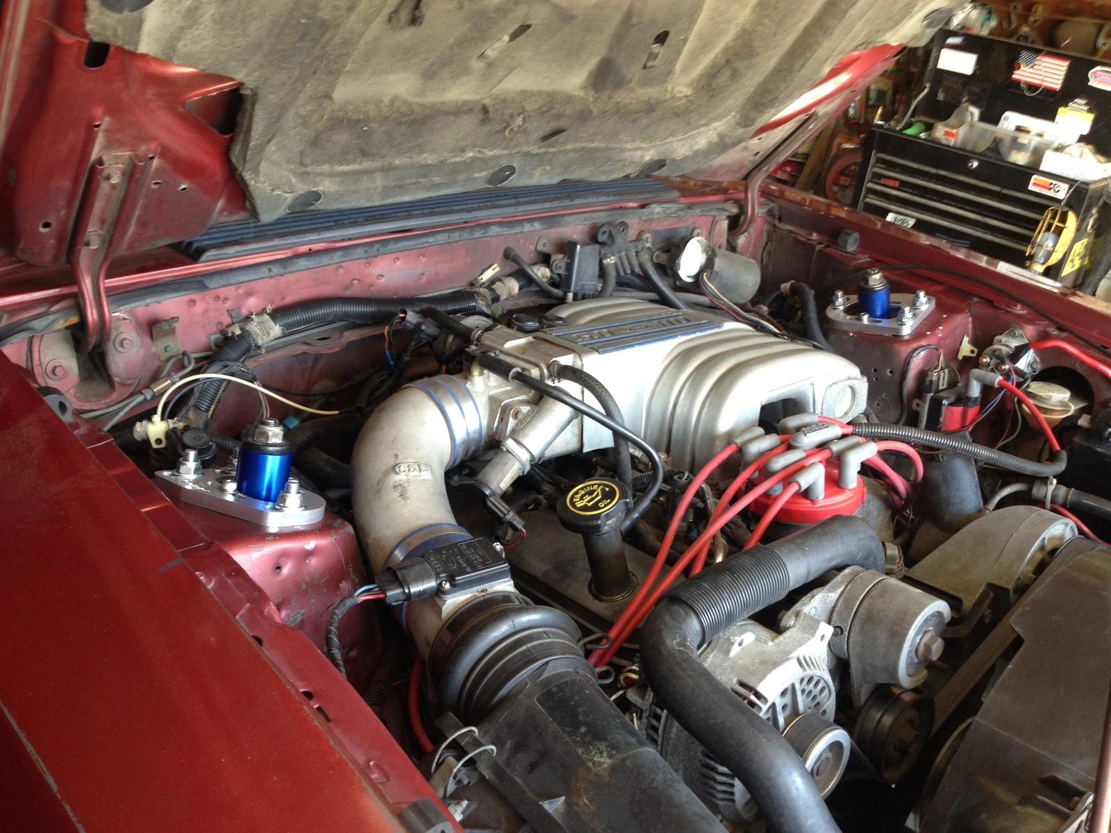

Thanks for all the help. Its been a few days, I works 24hr shifts, so by the time I get back to my computer I usually have it figured out. I went with strut, bump stop, strut cover, (sleave/bushing, washer, lower bushing, bracket, upper bushing, washer, and nut. It was snowing here today so Idident take it for a test drive or to get aligned. I was happy that my bolts dident hit my hood.

Here is a pic of what I came up with.

Finally made it o get an alignment. The got as close as they could, said I needed to grind some off of the tower to get full adj. Here is what they set it at.
bbk spec
caster left 0.6 3 pos
right 0.6 3 1/2 pos
camber left -0.7 3/4 neg
right -1.0 3/4 neg
right -1.0 3/4 neg
toe left 0.2 1/32
right 0.15 1/32
total 0.35
How close am I?
