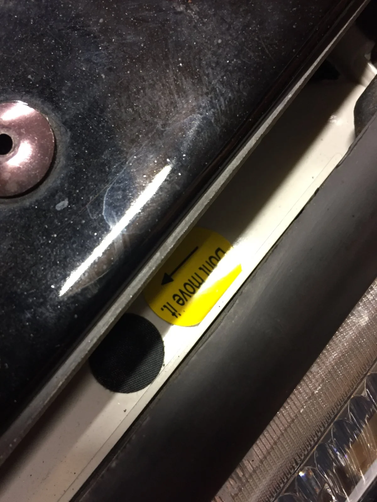

Doesbyour headlight have this sticker on top? If so, good chance they are all made by same vendor

The ones I got have that yellow don't move it sticker on them. Most of the ones I've found have that too, so I just assumed they were all the same thing.
