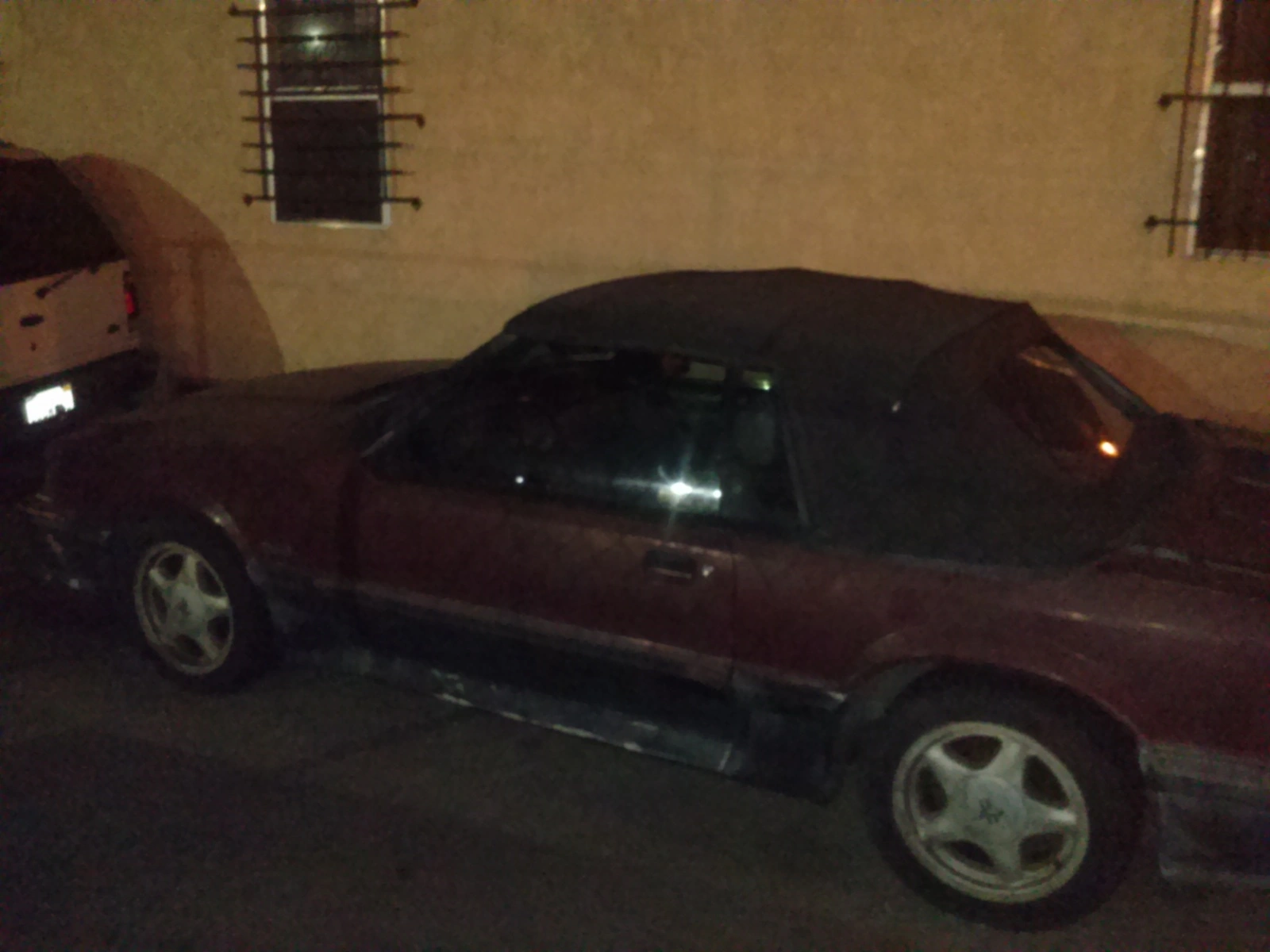

The car was sitting for 7 years
Its completely stock
Bought the car for 600 bucks
I changed the gas thank and fuel pump
I.guess thats what comes with a car that has been sitting for such a long time
Thats the car.
